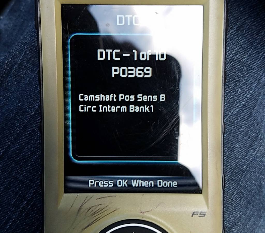

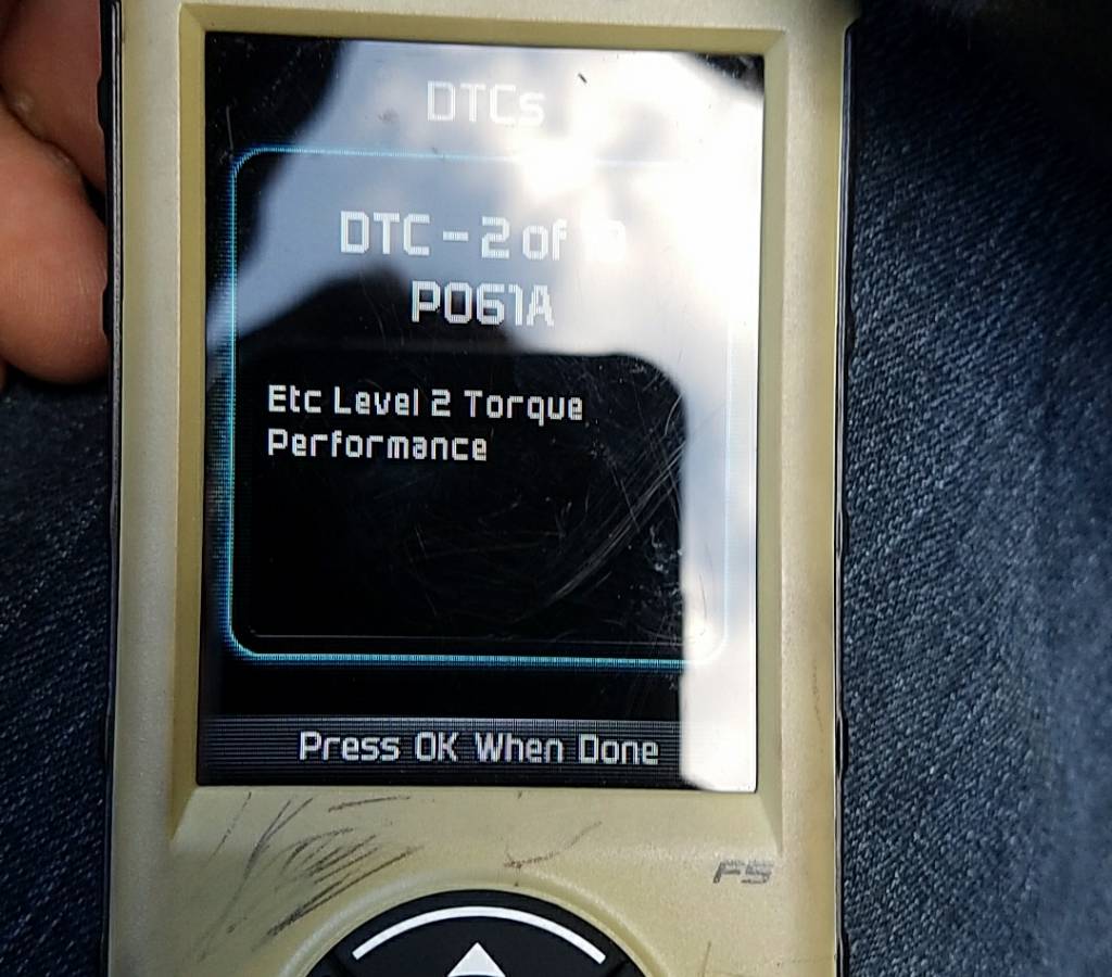

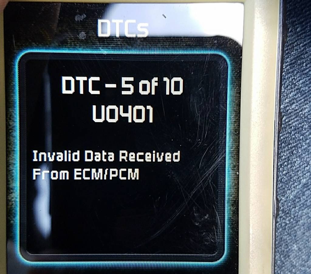

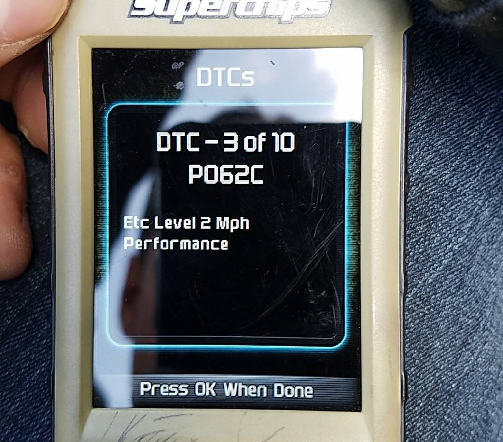

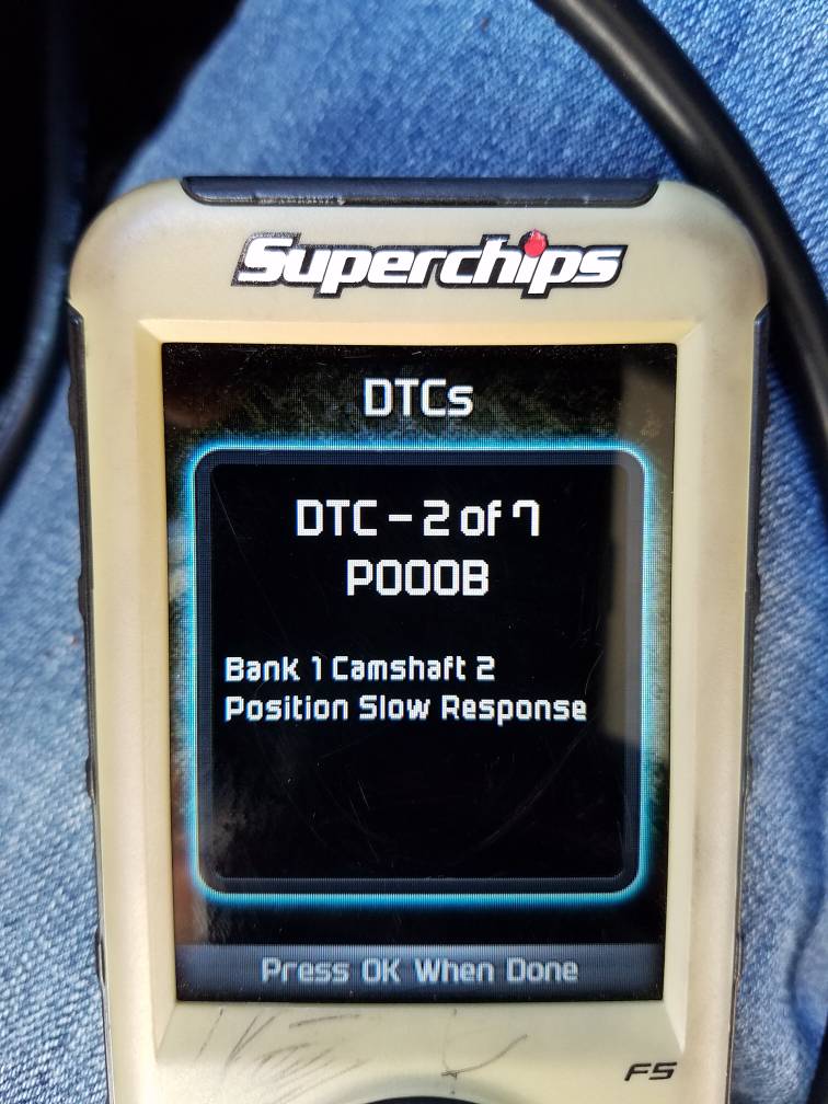

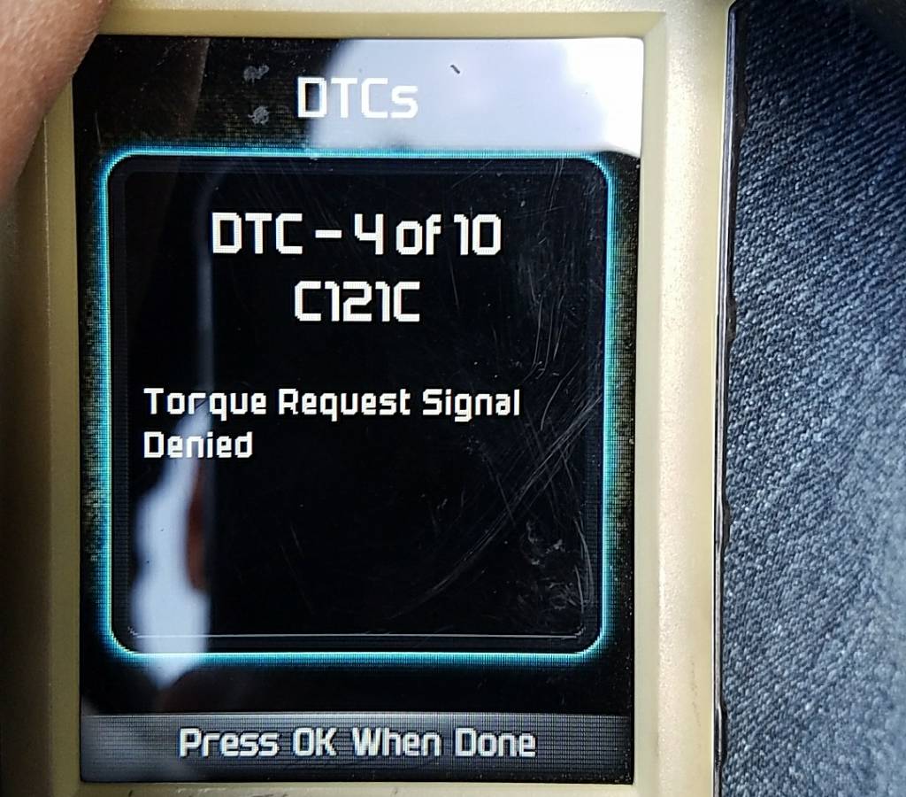

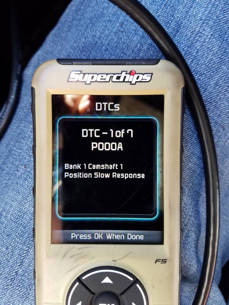

I have a 2013 jku rubicon. Has a 4 in lift all after marlet control arms, driveshafts, track bars etc. After putting lift tires and regearing my jeep my camshaft sensors come on after traveling on the highway for any length of time. The quickest it's come on was about 15 minutes traveling 70 mph and the longest was about an hour going the same speed. I reprogrammed everything in my jeep and it still happens but my speedo is spot on. Anyone else have this problem? Any ideas as to what it could be? These are the codes i pulled from flashpaq

I would work the CMP sensor as a separate issue - and that is likely a wiring issue.

U0401 I think is key to the others "[FONT=&quot] implausible data " the modules are sharing info and the changes are not programmed or accepted [/FONT]
So how do I go about getting this all fixed? It drives me insane when I'm in mid drive the lights come on cruise control stopped and then every time I have to slow down and I release the gas the jeep bucks. Also while I'm trying to accelerate it takes forever. I lose power in shifting and acceleration. I have a manual.
Sent from my SAMSUNG-SM-G891A using Tapatalk
a I suggested work the cam issue - the above list Is what to check...The circuits wiring and th connectors.
The programming may require a jeep scanner- I do not know if the combination gears, tires can be programed - might not be a selection.
Did you put a new Cam sensor in?
If so, was it OEM?
The cam sensor and crank sensor signals are used by the PCM to set timing and shifting.... if one signal is off timing you will get some codes.

Ok Idk how to check any of that haha. And yes I put new ones in. I had one from AutoZone in and the code kept coming so I replaced with ones from the dealership and same, keeps coming on.
So you replaced both. Did you do a relearn/reflash? Without a relearn the code will still show.
There is a oil control valve that needs to be replaced.
All of this is in a TSB. I can't find the tsb number right now.

How do you relearn it?
If you have a capable programmer it is a function in the menu. Otherwise the dealer should be able to do this.

Had them reflash. Hasn't come on yet but haven't had any long drives either. The check engine light was on after they refreshed it with these codes. But then it shut off a day or 2 later.

So does this mean I have to reprogram my tires and everything back in? Didn't think of that. If they reflashed the computer does that make it seem to the computer everything is back to stock?
IDK about the tires.
I believe it allows the new CPS to be learned, so the PCM is not looking for the old values.
