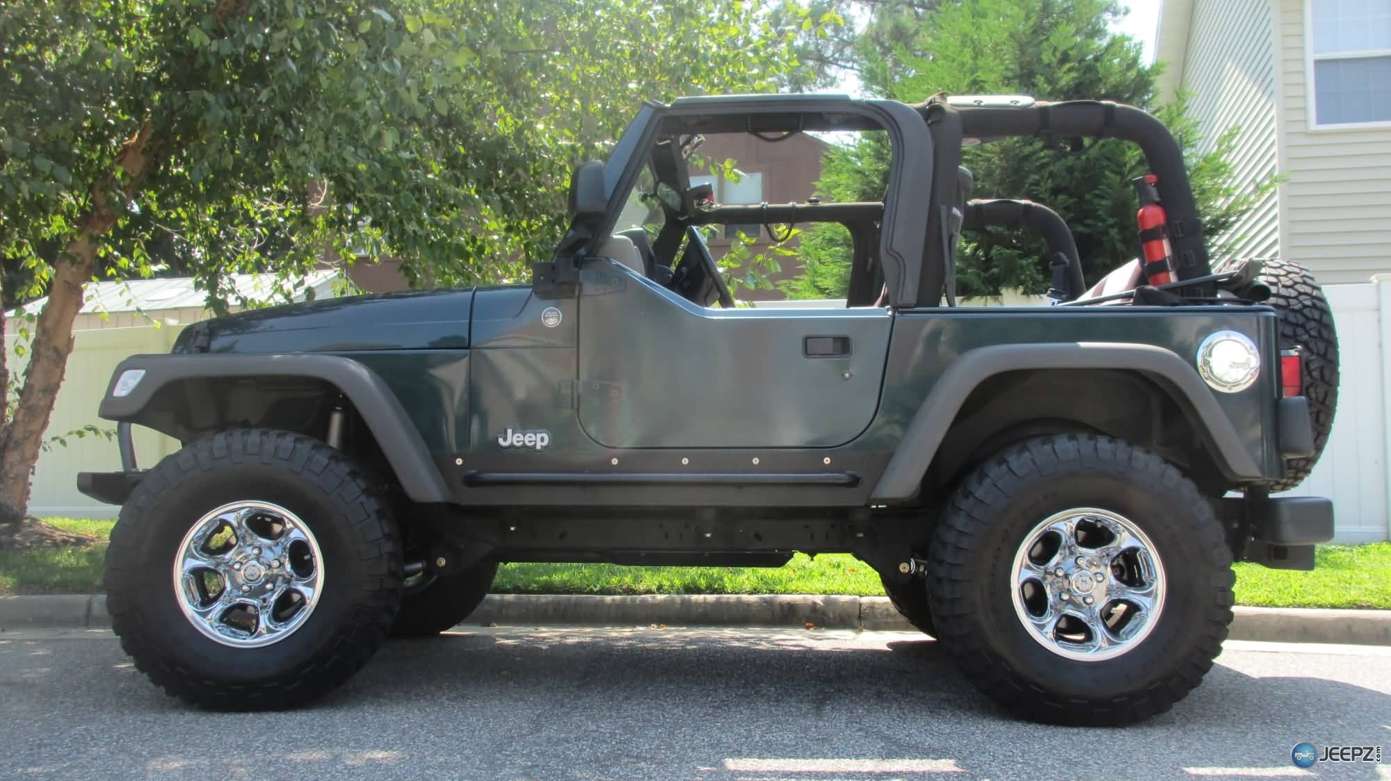

I'm running 33x10.5 inch BFG KM2s with a 2.5 inch suspension lift, and 1 inch body lift. I think you'll be fine for on the street, but if you do start offroading, you'll likely need alittle more lift.
I ran 33x9.5 for years without an issue. Being they are hard to come by I run 10.50 and they rub on the control arms with stick rims. If you get rims with more backspacing you won't rub.
If you disconnect your sway bar when off-road ing you will running the inner fender at full articulation. The body lift will help as Terry mentioned.
