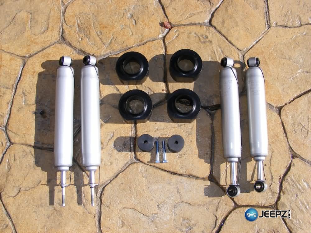

I'm having problems with my shocks making contact with the coil buckets on my TJ when it's fully flexed out. I've got some Rubicon Express shocks that came with my 2 inch budget boost some years ago. Anyone know if it's ok to mount these upside down?

Thanks guys. I did some research and didn't find much about this specific shock, then I went and actually looked at the shock - there is a clearly labeled top with an arrow pointing to which side should be up. I'm betting that this shock is supposed to be mounted can down. The overall consensus from what I've read (including JPNinPA's great link) is that oil fillled shocks generally mount can down, and gas shocks don't matter too much.
SteelHeadz - I bought some of the relocation brackets, and that will work great on my driver side, but on the passenger side it will push the shock into the exhaust (the exhaust is about 1 inch behind the shocks). My thought is that if I can mount the shocks can up, then it would give me just enough spacing to clear the bucket, where the shock body is larger than just the rod.
I either need to move the exhaust, or do something with the shocks, and it looks like the shocks would be easier.
