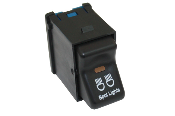

How about this ($19 including shipping):
items in on board air usa store on eBay!
