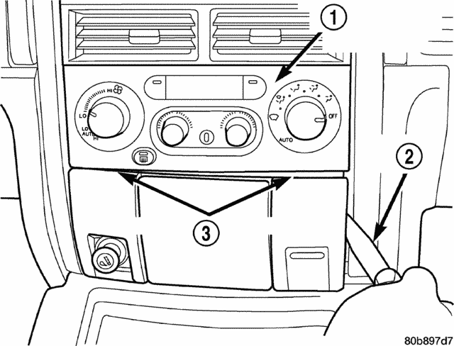

1 - HEATER AND AIR CONDITIONER CONTROLS2 - TRIM STICK3 - CENTER LOWER BEZEL

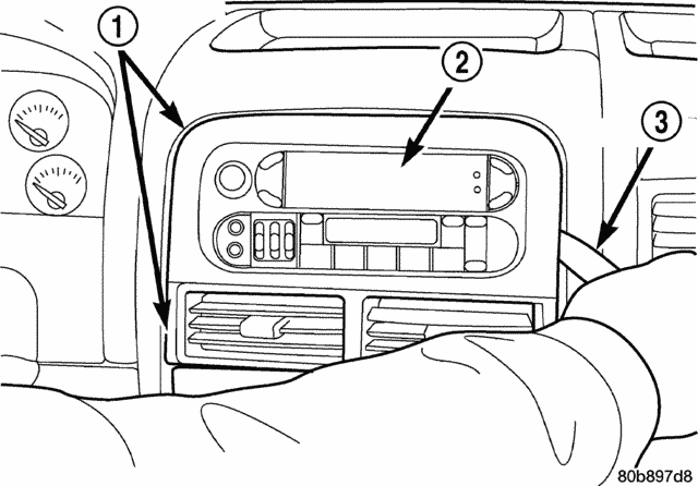

1 - CENTER UPPER BEZEL2 - RADIO3 - TRIM STICK
No screws on the bezel, however if your not careful, the bezel will crack. Work on it all the way around as you pry it off.
