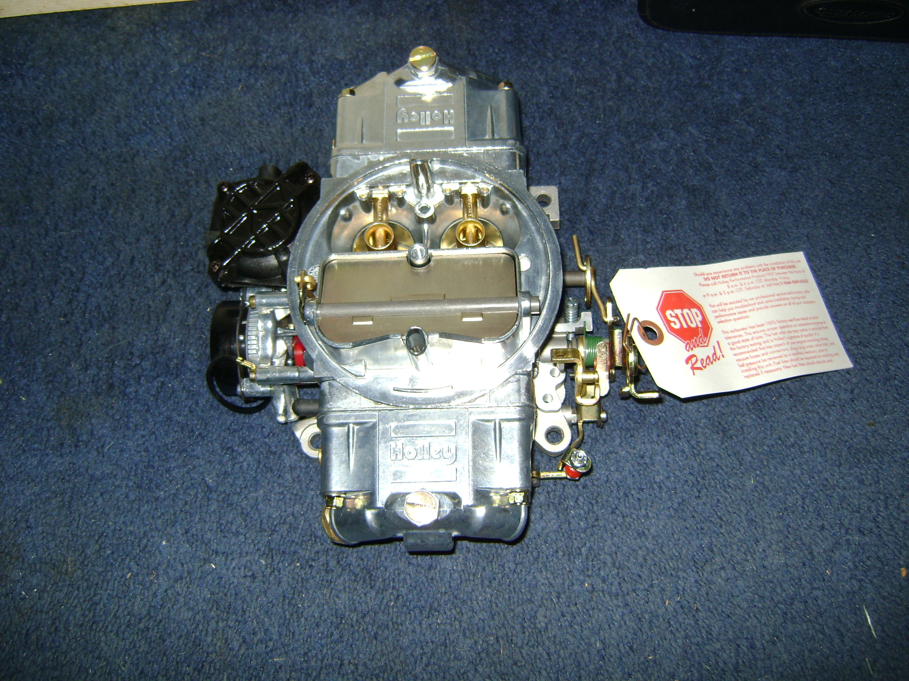

Now that's a carburetor...ar, ar, ar.

That is one pretty carb ! I'd almost marry it if it were legal ! Just kiddin' , I'm not that far gone .
It looks like the venturi's are removeable as some Holley carbs are manufactured to do , if so , you can tune to your hearts delight and hoping as SUPERJ said , achieve the correct volumetric efficiency . Really hoping this works out for you , was worried that this much cfm is overcharging the engine too. Really curious about your neighbors recommendation , but I would never question a pro engine builder since they're usually up on their engine math. But at the same time , I wouldn't argue with SUPERJ about smaller cfm. The 2bbl that a 304 and even a 360 comes with is about 450 or so cfm . The only way I know that an engine can get away with more carb is more cam overlap or lobe separation angle to achieve longer intake open for more mixture .
