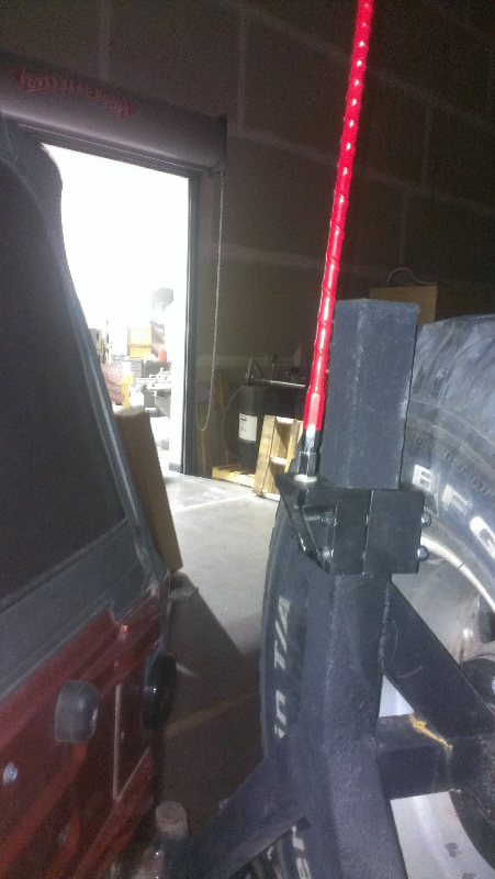

I got everything mounted late last night and hooked up the SWR. Without any tuning I got 1.5 on the meter set to channel 20. I'm going to do a little fine tuning tonight and see what I can come up with. The weather channel worked fine and I heard conversations from the highway a few miles away. I think it should work just fine on the trail with only 20ft between vehicles. thanks for the help!
The 1.5 SWR, was that off of the radio meter or an external?
It was an external. It came with the Uniden 510 I won on this site a few years ago. Is one more accurate then the other (he asked afraid of the responses sure to come) ?
