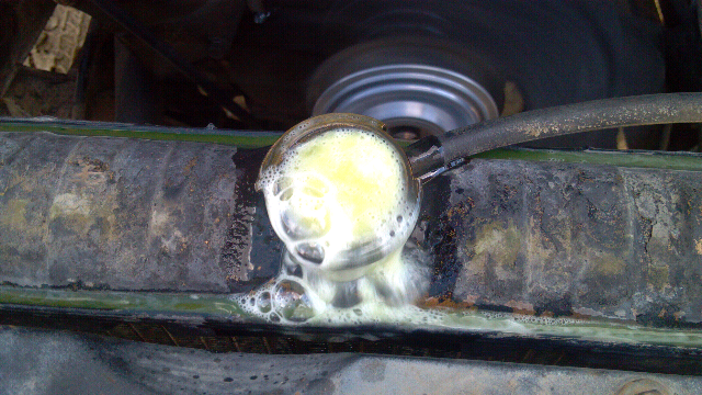

Burped the system i think. Bubbles were coming out of it
It over heats while driving or while idling? Those are signs of different things, is why we need certain answers.
Questions after looking at your photo
1. Is it still overheating? If so at an idle or only while moving?
2. Maybe its just the photo, but the coolant looks funky........ If the engine is cool with the cap off (providing you can see the top of the inside of the radiator, if not drain a little coolant out), do the brass channels/ tubes have a layer of or even clumps of white chaulky stuff around the the little holes the coolant would travel down?
3. When you over heat, does the overflow activate and dump the coolant into the reservoir?
4. Lastly, mostly because I'm curious, how long did it bubble like that?
I'm thinking that foaming looks like trapped radiator flushing agent. If it is that stuff it's ineffective for coolant. I wonder how recent the radiator had been flushed, if that's what it is?
