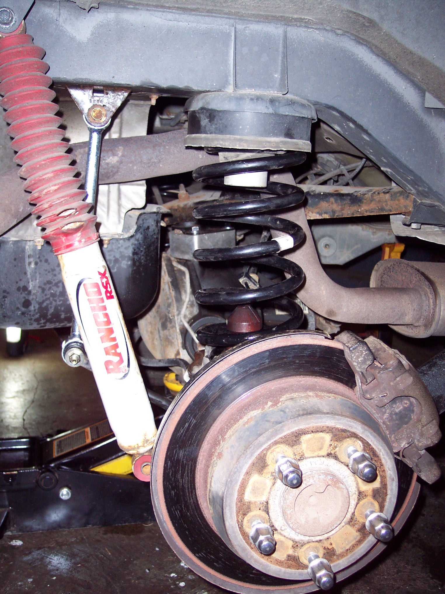

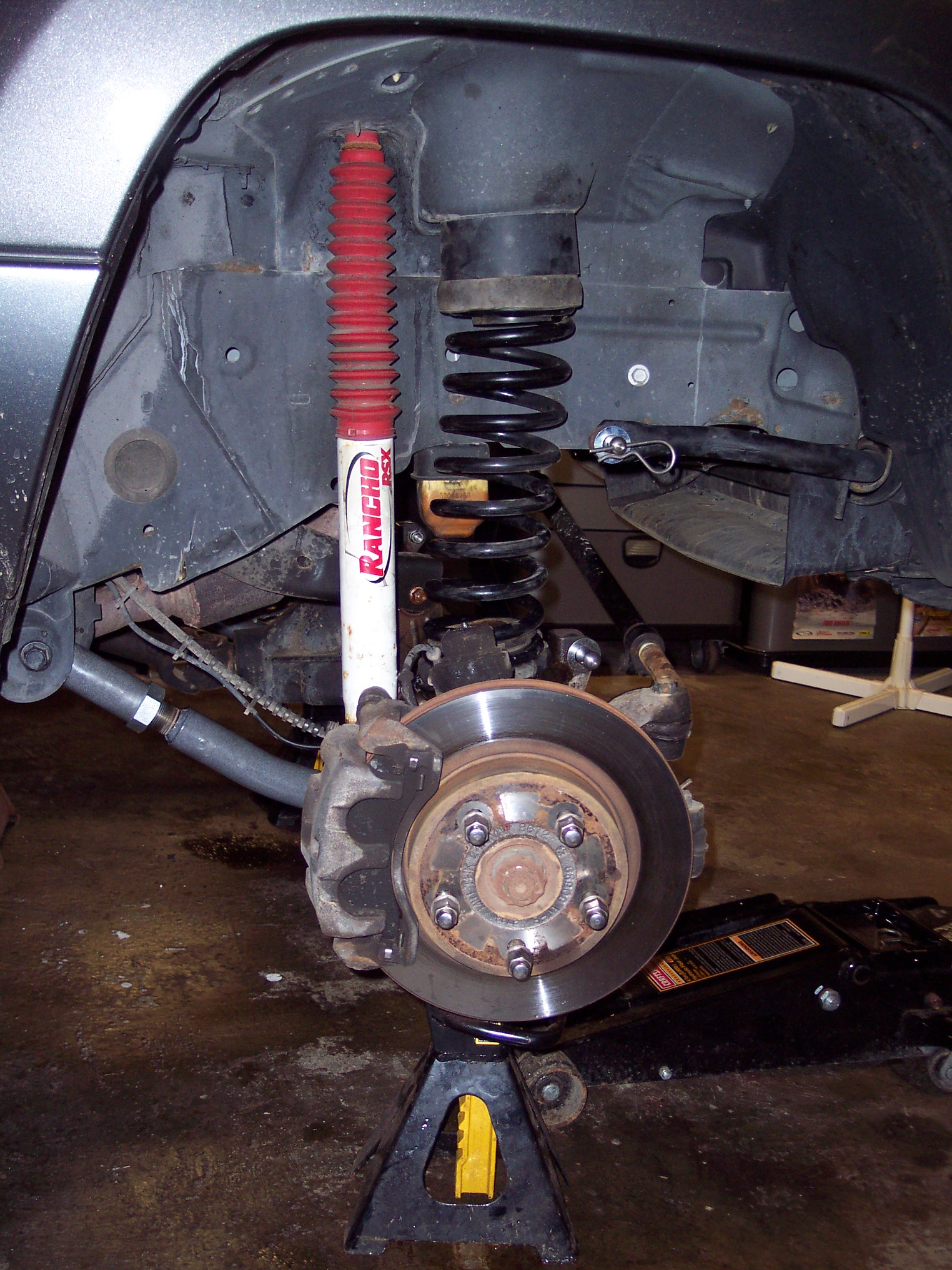

pull the shocks, and see if they still have a charge to them... they are gas.. and if depressed, the should be stiff to do so.. easy... and they need replaced... as for as coils.. never replace them with stock...:-) but i'd try the shocks first... rancho 9000 gas shocks have worked well with her old man emu lift... and they are avl. at any advance auto..
as for the shock replacement.. hand tools , a jack to remove the tires.. and some time... the front would take longer then the rear.. and use antiseeze
