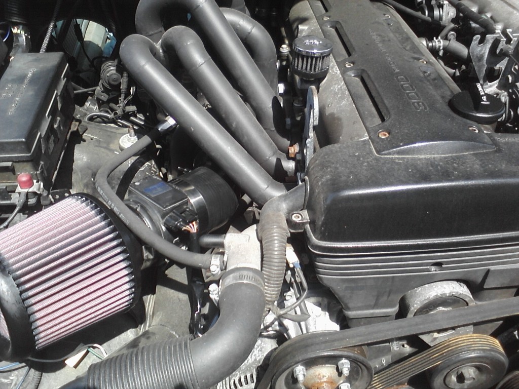

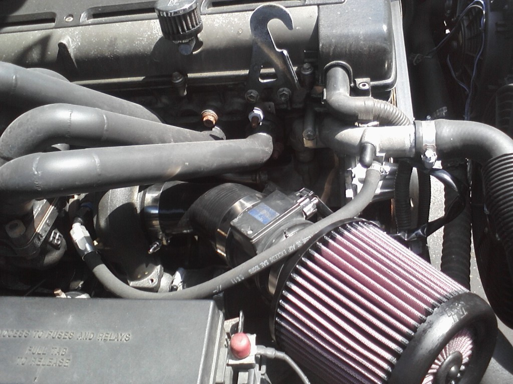

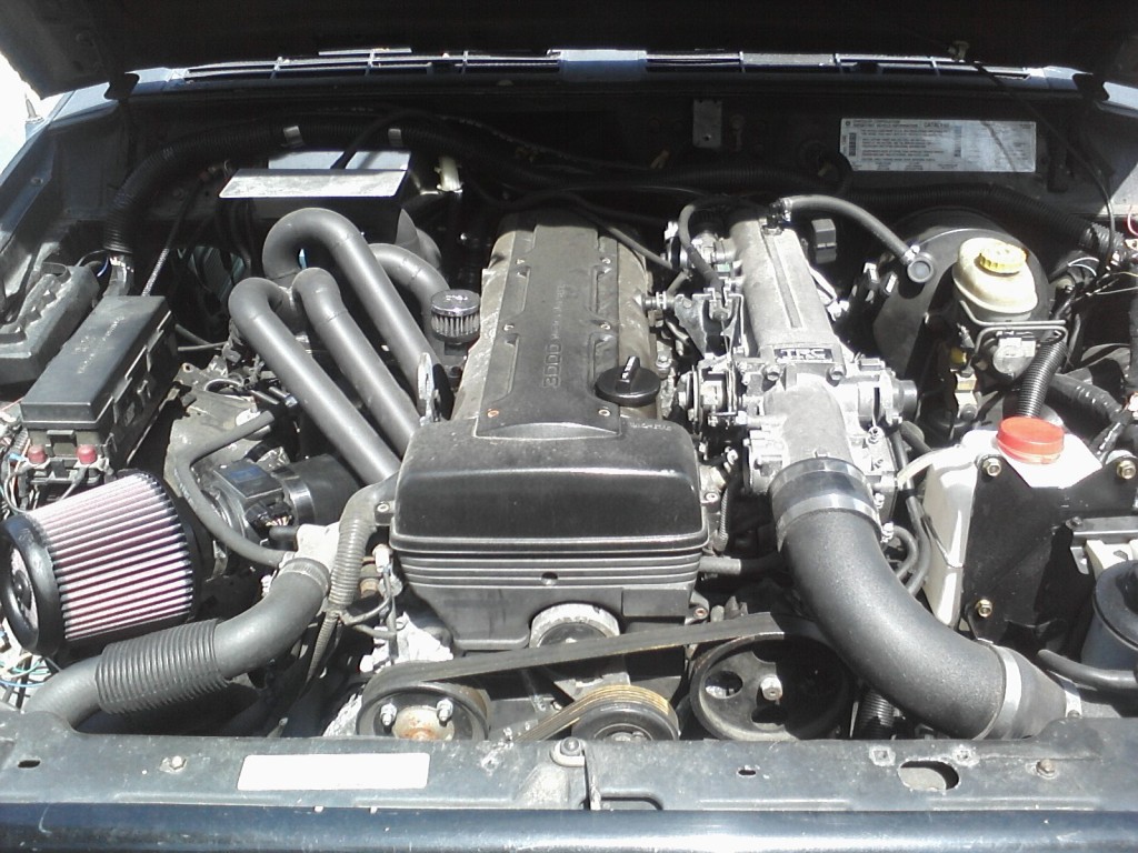

J-Spec OBD1 conversion to US-Spec OBDII conversion:
New MAF sensor and air filter setup physically installed.

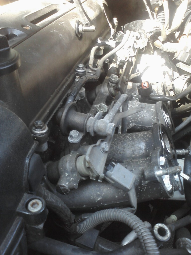

New injectors are bolted in, but I'm waiting for the proper injector plugs to continue. This pic is actually from before I swapped the rail. USDM injectors have purple plastic.
Middle fingers up to the EPA telling me "You can't do that, you should have asked us first."
Are you going to be able to make this street legal? I'd hope that if it produces less smog then the original there would be a way to make it legal.
I believe so. I am wrapping up the Obd2 conversion now, but I have a no fire condition. Troubleshooting now.
OBDII conversion complete. I had 4 codes, but all were related to devices that are no longer there. Resistors have been wired in and I will be clearing codes tomorrow. I expect more to show, since I still need to finish fabricating the exhaust and I don't have the rear OXY sensor wired to the new ecu yet.

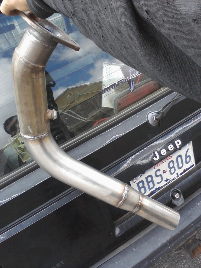

Down pipe and exhaust setup is built and complete.

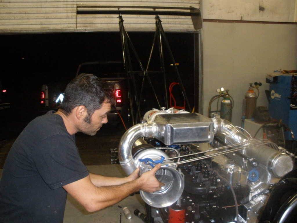

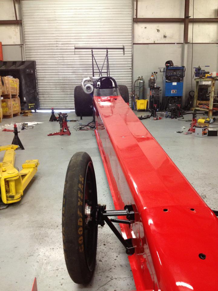

I've been really distracted with a Top Diesel project that sort of fell into my lap, and the race is this weekend, so it's hectic...however I did manage to get rid of the last Obd2 code and no longer have a CEL! Still need to wire in the rear O2 and fix a couple of safety inspection gigs. ANyway, some of you may be interested in the distraction I've been working on:
More pics are here if anyone is interested:
