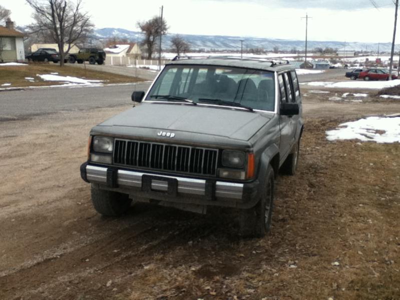

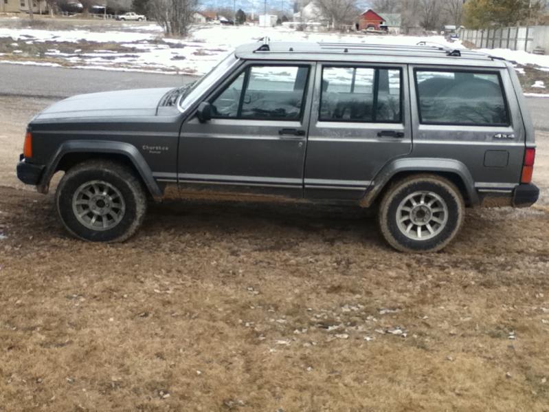

I just bought my first jeep. It's an 89 Cherokee with the 4.0 and is 4x4 and 138k miles. I was just wondering what you recommended for oil weights and brands. Thanks!!!
