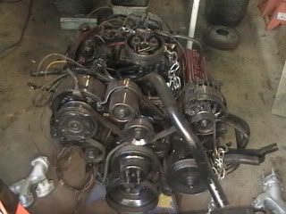

Anyone have experience with throttle body injection? Good idea? I have an engine that my auto teacher pulled from his 94 suburban because it was burning oil so I'm tearing the block down and taking a look to see what the problem is, the pistons look to be in great shape, just going to see if we can figure out this problem first but it's throttle body injected and if I'm going to start putting money into then I want to male sure I know what I'm getting into with it, I got it torn down all the way to the short block in less that 2 hours this morning any help is greatly appreciated.
Tbi motors are good. Most are roller blocks so a roller cam swap is cheap. One piece rear main is nice. Some vortec heads with an intake you will have some fun. Built about 5 of them. One I run in my 83 chev and am in low 13s.

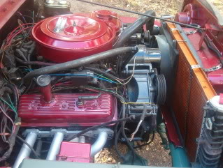

I got the v-6 4.3 TBI , best gas mileage I've seen in a long time getting almost 26mpg around town in my 3b everything else I own gets around 13-16 if I'm lucky the 3.7 in my wifes liberty gets 15 around town with the fuel injection I'm contemplating putting a 4.3 TBI in that also

I'm extremely interested in the 4.3 it weighs almost 100lbs less than the 4.0 and it has a little more power, so I'm thinking that might be the way I want to go because the Gen 1 350 TBI weighs in at about 550lbs the 4.0 weighs 515 I'm trying to save weight because I've added weight so I'm trying to adjust to get decent gas mileage, fairly good power and reliability. I've heard alot of good things about the 4.3 and it seems just right for me besides I'm on a crazy short budget and for all the things I need to do to this 350 to get it up and running is just out of this world. I live in Canada so everything is expensive here -.- but I can probably find a decent s10 for cheap I don't really need V8 power and the 4.3 sounds like an easy enough swap.
pulling from the donor to the install took me by myself 8 1/2 hrs than the wiring and other odds and ends about another 4 hrs . take into consideration I had all power air tools , everything I needed was at my disposal , also doing this kind of work all my life also helped not having to stop every 5 min to look into a manual ,
but still anyone can do this swap if they take there time , and have all the proper hand tools , I'm not talking about one of those cheap $20 socket and wrench sets you get at checker , those will only cause you to bust knuckles and you'll see how fast they bend or break on a tight bolt
the late 80s early 90s s-10 blazers are the easiest swaps mid 90s to early 00 are a little more difficult since they have a bit more that needs to be swapped along with the motor
