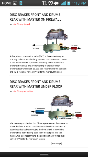

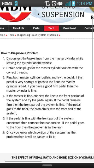

I was thinking it could be the new proportioning valve the place that makes it has this on the site. I'll try to up load it. But when I read there tech info it sounds like it's my proportioning valve. That's bad but its the 2 nd new one I have had on there???? The valve is mbm pv 2.
If the pic don't show up goto "mbm" site and look under tech.

The more I look into it I'm thinking I have a bad proportioning valve from mbm I found some at summit but do I get a new brass pv2 from a different co. With 9 good reviews, or go with a adjustable one from summit or the ssbc has one but they look the same??? Ok thinks

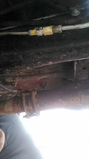

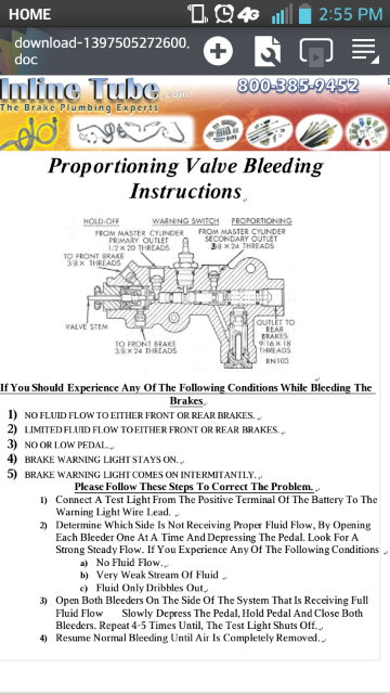

My jeep came with disc brakes in the front. I had great brakes once but they would stick some times making a long story short I slow start replacing everything then one day I found out is was my new booster making the brakes stick so replaced that then the master started acting up replaced That then my proportioning valve started leaking which was new so replaced that again and it started leaking again and in the middle of all this crazyNess my brake bleed out good can find air in the lines or leaks but the brakes are soft and the rears lock up. I talk to a guy at in line tubes and said the proportioning valve needs to be set using the brake warning light. I'll try and up load the pics for this.

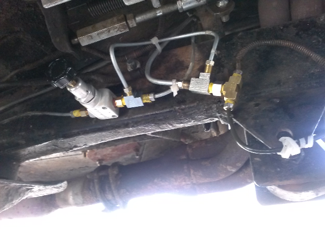

So I guess I'll try to bleed out using the brake warning light. If that does work I'm thinking about running the fronts straight to the master and using a adjustable proportioning valve on the backs only.

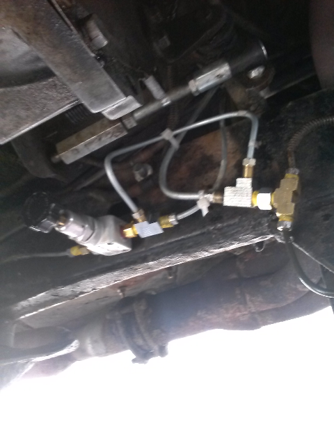

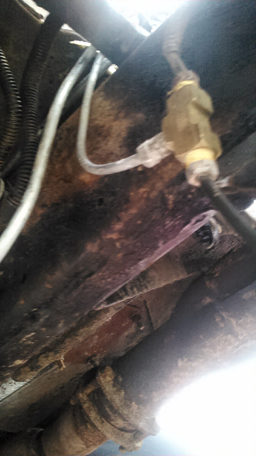

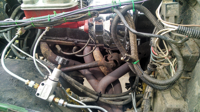

It may not look pretty but it works. And me and my jeep

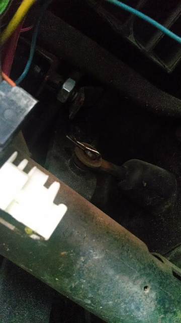

I had all sorts of brake issues on my 87 yj when I first purchased 9 yrs back. I did a ton of research on the issues and they were similar to what u are having. What I found out was that it was the booster, and the valve. So I found a write up on line that had directions to take the entire set up out of a older f150. The entire package of booster, master cylinder, and the valve. Had to pick up some adapters to connect my brake lines to all the new components. And then also modify the little push rod a little bit. I run large mt tires and have stock axles still. Stops on a dime now and locks all four brakes up if I have to slam on them even with all the heavier mods my jeep has and the big ass tires. Good luck.
I found that hang up it was the booster not pushing the pin in at the master far enough. I have to make the adjustments on the brake petal rod that goes through the firewall to make it longer to push the master cylinder further. And I did have the booster adjustable pin at the master. Brakes are good and strong now thanks for your help. Here are some up dated pics.
