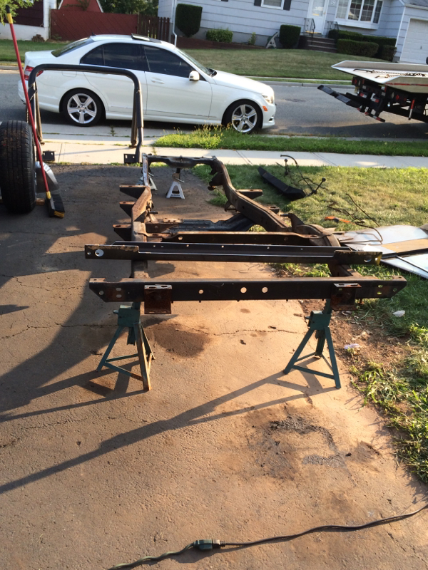

The doner bar was from a 91 YJ. I think what will be the determining factor is how well the CJ bar fits the YJ tub. From what I have seen so far..... The last owner had some questionable mods as well as a rough driving style.
I have no intention on using the spreader bars. If I use the YJ bar, I'll just try and weld something to cover the holes. I appreciate everyone's response. From the pic attached.... I have a long way to go!!!
