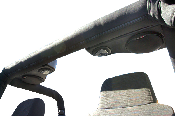

If I were you, I would relocate the speakers for 2 reasons: (1) they are too small to reproduce any type of base sound, so they will sound like crap, and you will have to turn the volume up to hear at a decent level, which, in turn, will cause the speakers to break eventually, and (2) they are not in a good position to reproduce good stereo sound (if you are driving, you will only hear the driver's side speaker; the other you will hardly hear at all). But it's up to you... The advantage is that they are hidden and out of the way, but I have heard there are some conversion packages to put 6.5 speakers behind the dash (at least for YJ's but it should be the same).
You could try one of these setups:

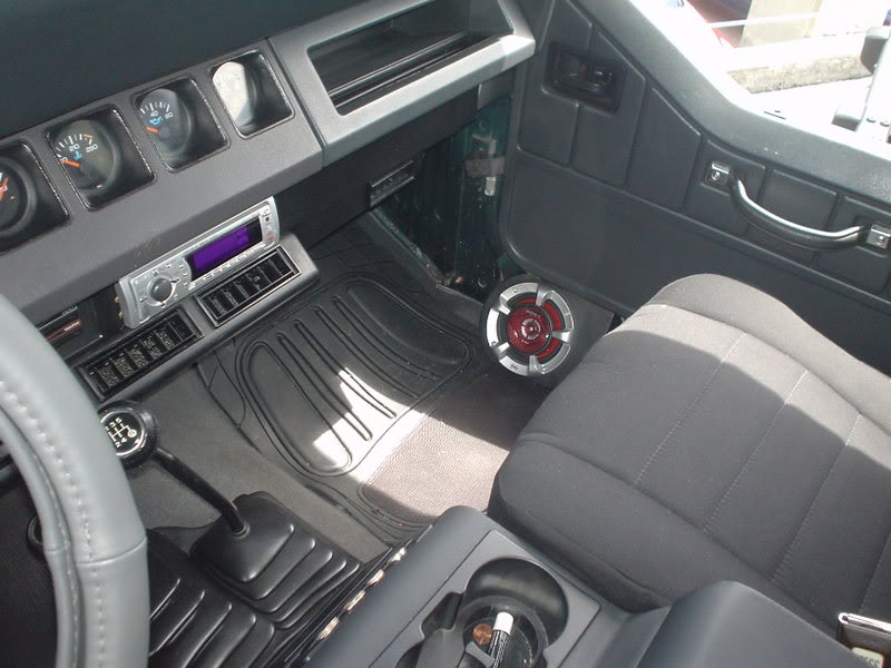

Mod Pods (this is from my Jeep; I have since had to replace the speakers):

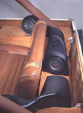

Sound Wedges (also from my Jeep):

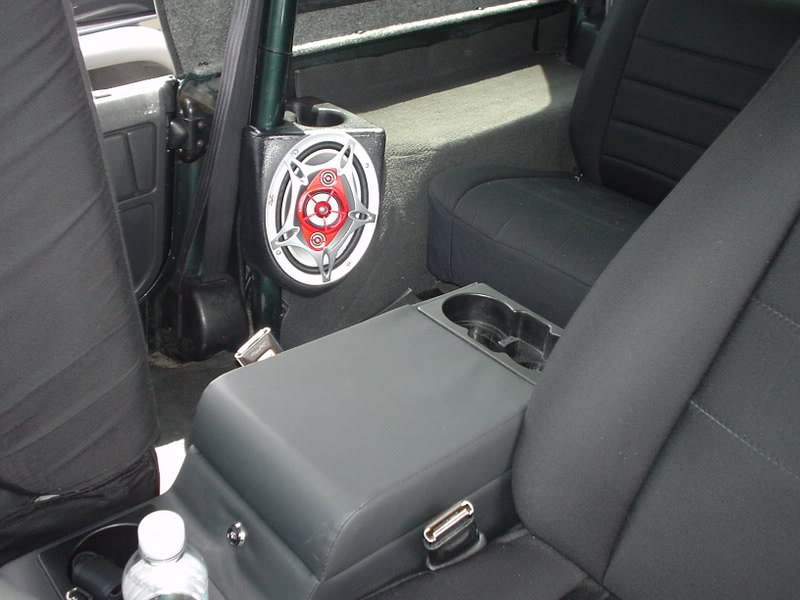

Roll bar sound Wedges (by Vertically Driven Products):

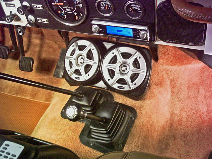

Quad Pods:
Centra-pod:
I've never really had any experience with boss, but the built in EQ is a must. My amp doesn't have an EQ and the highs going to my subs make it distort, so I definitely need to have something to keep the highs out. Do you know the model or about how much it is, by chance?
Mine is a Boss MR1420W and I think it's than $100 at walmart or Bass Pro, prob do even better online. I tell ya I haven't had much luck with CD players. I've had several top of the line units that didn't last. I love my music but I'll be buying the cheapies from now on.
I would absolutely love to relocate these speakers, however the person who had it before me thought it a good idea to cut holes out of the dash for his crappy speakers. So now I am stuck with terrible speakers in terrible holes that are horrifically ground out that are in a crappy position. And I really like those roll bar sound wedges but I don't have that kind of roll bar, so those are out. I would like to get the quad pods and the centra pods at least. If I get all these speakers I'm going to have to get a 4-channel amp for the front speakers and the rear quad pod speakers, and a 2-channel for the subs in the quad pods. Just gonna take a lot of time, money, and patience on my part I guess. But thanks for all the ideas, I'll definitely have to look into them!

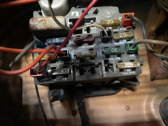

I have an 84 CJ7 and trying to replace the streo but cannot locate a constant 12V source for the memory. Suggestions?
If you radio powers on now with the key off you could pull fuses until it powers off.
If its not marked on the fuse box check owners manual in the event it was clustered with other items. Might be with dash or dome lights.
The one in the lower left looks like is states radio.
the bottom left on that picture is the radio fuse. its labeled. you can use the clock power to run the memory line to. clock is black/white
