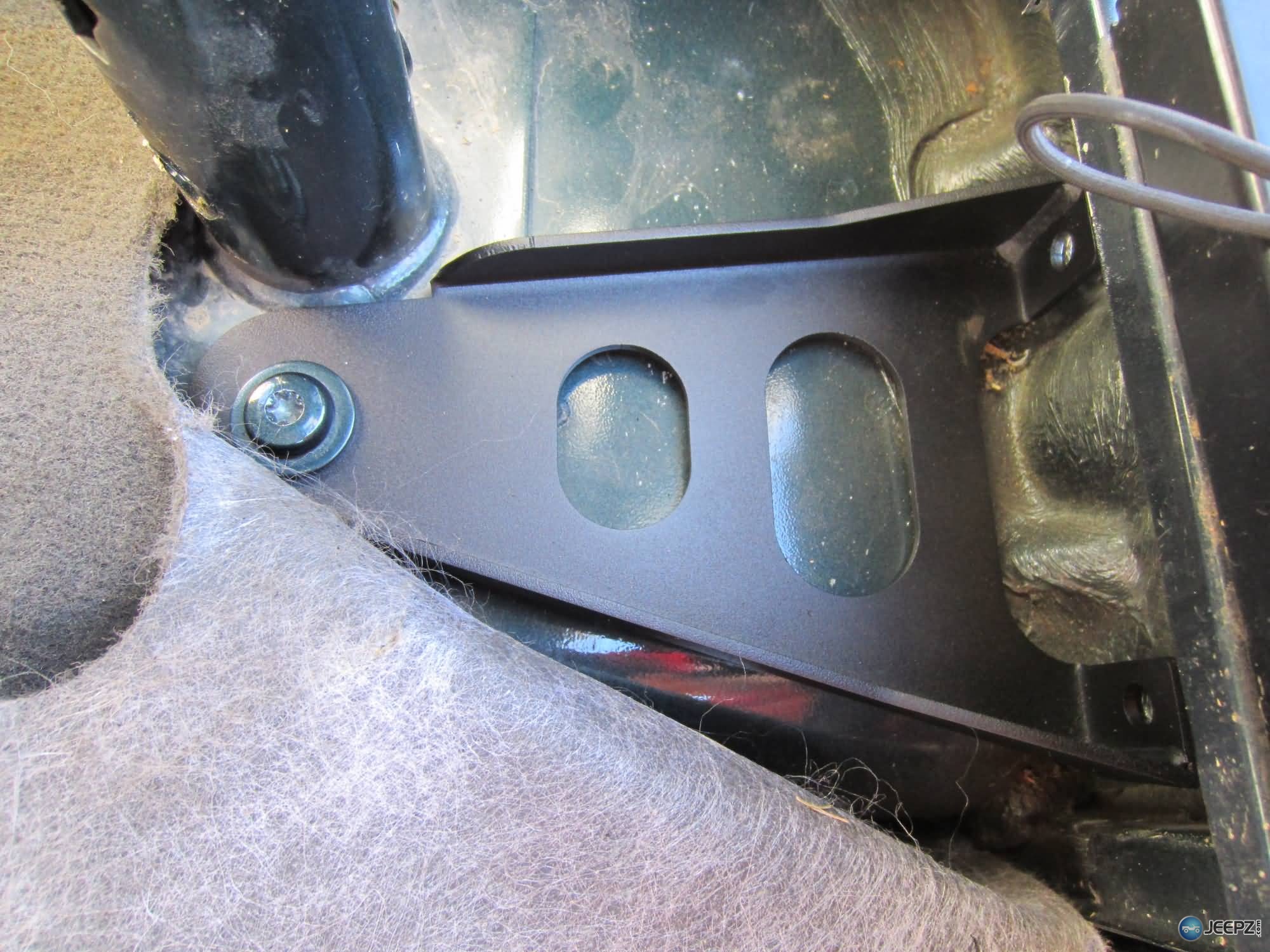

I have a Gr8Tops tire carrier on my TJ. I mention this because it has a cool little bracket that ties the hinge into rollbar. It would be pretty easy to add, and should help out. Here's what it looks like
http://www.jeepz.com/forum/product-reviews/40222-exogate-tire-carrier.html
