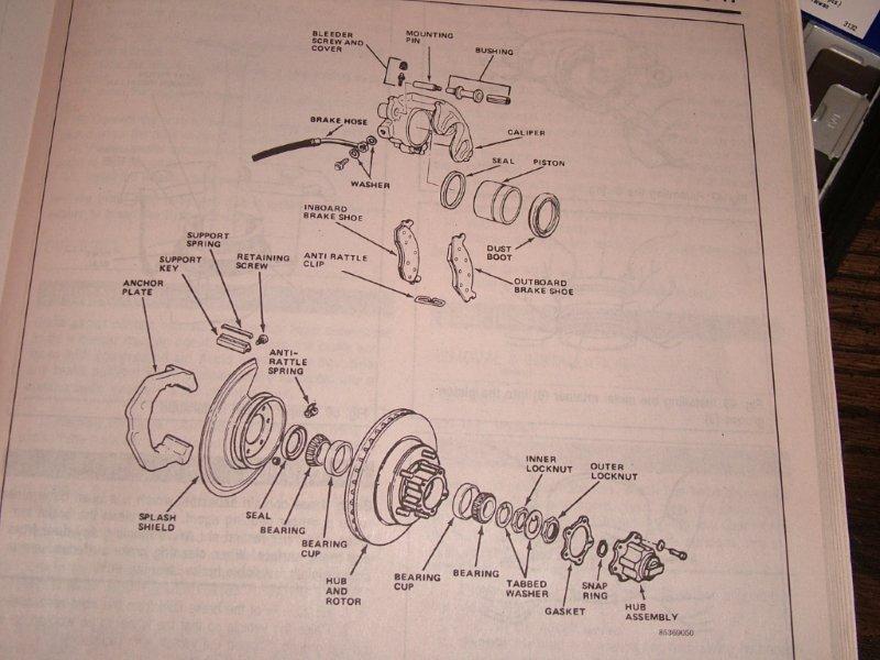

Clicking noise is driving me crazy so today removed both calipers, pads, cleaned, wire brushed reassembled calipers then went for a test drive. Still clicking. After checking out several posts I understand I'm missing spring clips? Where to install as I have no reference either side. Thanks for any input :???:

Thanks for for the response JPNinPA, calipers appear to be factory and recall po telling me he just replaced brake pads when I purchased the 1979 cj7 last year. The clicking noise began about three months ago but was very slight and would cease when slight pressure was applied to the brakes.

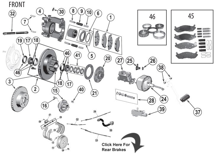

http://www.quadratec.com/jeep-replacement-parts/jeep-cj5-cj7/cj-brakes.php That's for the fronts Is the noise in the rear?
Thanks for the diagram especially the small inset which shows the location and orientation of the pad spring. Problem is front disc pads the rear brakes are drum brakes. Ordered springs from Morris 4x4 and will install in a few days. Just noticed in the diagram that I may also need anti rattle clips of which I have none. So must investigate for a source.
