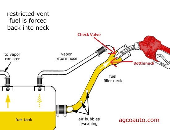

the pump kicks off often suggest a vent valve issue AND P0455 showed a TSB that may help both
click on attachment
Wow typically the new gas cap fixes it. It fit properly and tight?
The gasket in the cap gets worn, damaged or dirty causing a leak. The leak doesn't allow the evap system to trigger the code.
Look for cracks in the lines or for loose fitting lines to the canister.
That hole in the filler should have a tube attached.
