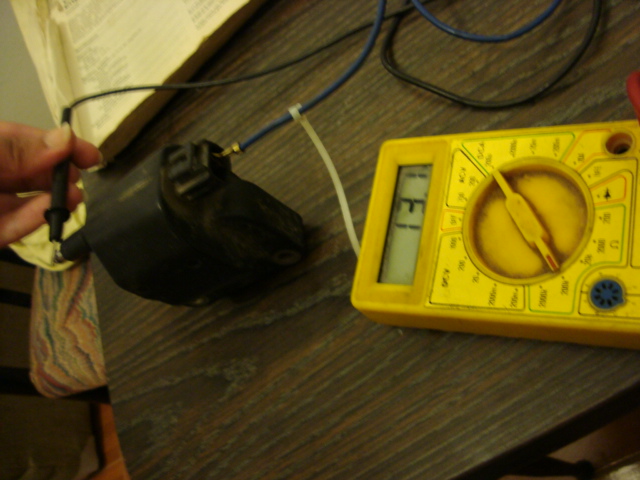

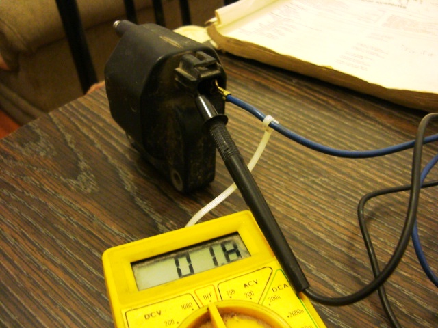

yesterday i checked the primary resistance and a value of 1.8Ohms saw the spec and the max is 1.2Ohm to me 0.6Ohms difference is very little but the sheets does say to replace it?

see pics of the meas that I took.

Since the coil circuit high side driver is controlled by the PCM and the low side is switched by the ASD to the PDC, and the diagnostic test you performed indicates a faulty coil unit, i would replace the coil rather than assume that it's the PCM. Re- check the harness from the PCM to the coil for chafing. The primary resistance at 70-80*F is 0.71-0.88 ohms.
Edit: Your resistance values are out of the specified limits.

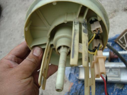

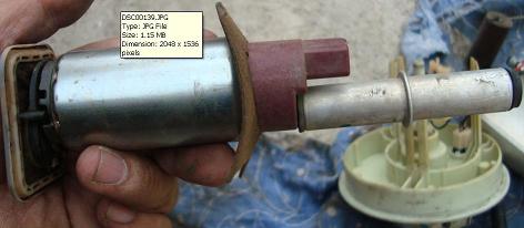

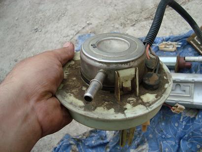

yesterday i took a part the fuel pump, did not find any significant damage on it my does not have a ruber line from the pump to the sending unit is a metal tube and the sendi unit has hard plastic one that goen into the one from the pump.
I connected the 12V to the pump worked as normal.

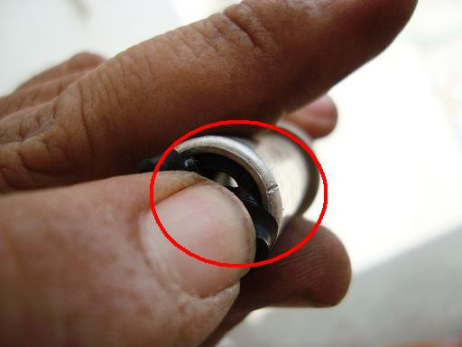

Also took apart the fuel pump... again. found this (sse pic
