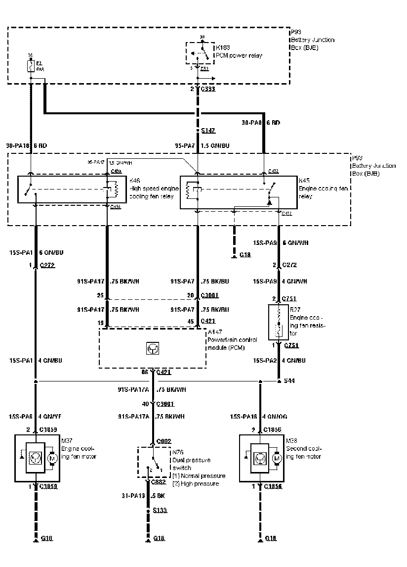

Hi gang, from this and other forums I got it straight about wiring up these fans using relays and such. Now what parts would I need to incorporate a slow startup for these fans? Could I wire in a capacitor? IF using a capacitor once it reaches capacity does it just DUMP amperage onto the line? (and POP goes your wiring)? and where in this circuit would be the approapriate place to splice one in?(Thanks to Coiz for the images)

Only NOW do I get it! That resistor (R27) on the shroud provides the slow speed and I don't imagine that's going to jolt the fan motors as I feared! So just a pair of 30/40 or a 70 amp relay ahead of the whole shooting match should do the trick then! ...unless I'm wrong again!

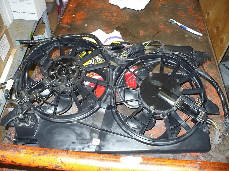

BTW this fan cleaned up really well using De-solv-it and some ArmorAll
Before;
and after;
...not that I'm building some trailer queen

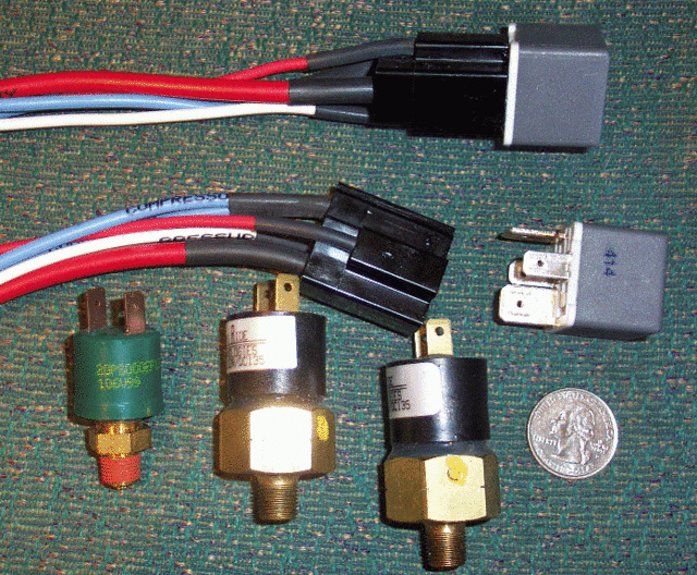

Called my local NAPA store today to get that HD 70 amp
(and other) relays today and they had no idea what I was talking about. I did my best to describe that photo that Rollbar posted but they want a part no. Is anyone familiar with that relay? It appears to be 4 lug with a 1/2 inch primary lug the other three standard 1/4 inch.

Well got that relay in as promised and it looks like the 70/80 amp pictured but the shop favors Carquest and this was made in China.

Well I gave up on waiting on Amazon partners to get a Hella relay off to me so I revisited the boneyard today.
Can anyone tell me if these are the correct relays?
I think the little one is the high speed fan relay
...but what's up with this green one?
