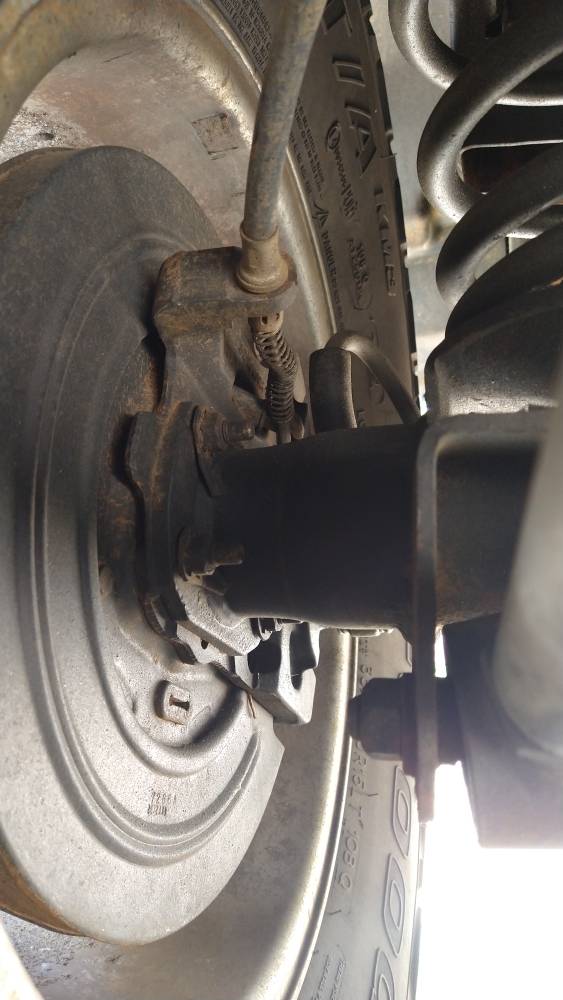

I looked at the calipers that I have on my Jeep, and they only have ports for the hydraulic fluid. They seem to lack the spring/corkscrew mechanism found on some disc brakes... That's a real bummer. Thanks for taking the time to find that info for me. May your bolts always break free and your nuts stay where you intended.
This is the passenger side rear brake, looking from the front of the Jeep back. Parking brake is at top, it's the part with the spring.
Does your axle not have these mounts? The parking brake on the Ford 8.8 doesn't use the caliper itself, but instead operates a pair of brake shoes. My 8.8 has both pads and shoes on each side.
Sent from my moto g stylus using Jeepz.com mobile app
@TerryMason That's pretty handy, but unfortunately my calipers don't have such a bracket, spring, or anything like that. Just simple small calipers with a port for the hydro. Thanks for the picture, and I appreciate the time you put into helping me.
