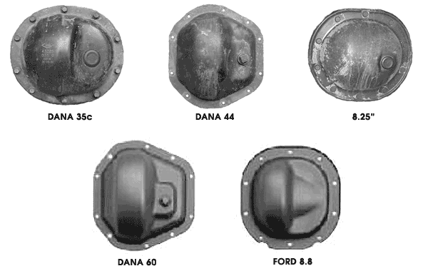

Here is a photo from rustys

Also I did some research on Dana's website and found out there the Dana 35c so is the 35c stronger then a stock Dana 35 axle?
All the c means is its c clip style.... Both are equally crappy
Actually what Dana did was send the parts to Chrysler to assemble which makes the c stand for custom since all the Dana 35s are c clipped

also, just look at those diff covers. the front is always the d30. the rear is the one you have to compare
its probably a d30 front (always is in front) and a d35 in back. i think the d44 only came in 87 or so xj and very very rarely in others and then the 8.25 started in something like 93 or 94. if i remember right.
87-89 YJ's are non-c-clip D35 rears. I do not know if 84-89 xj's are equally equipt, but I always was under the impression that the c stood for C-clip
