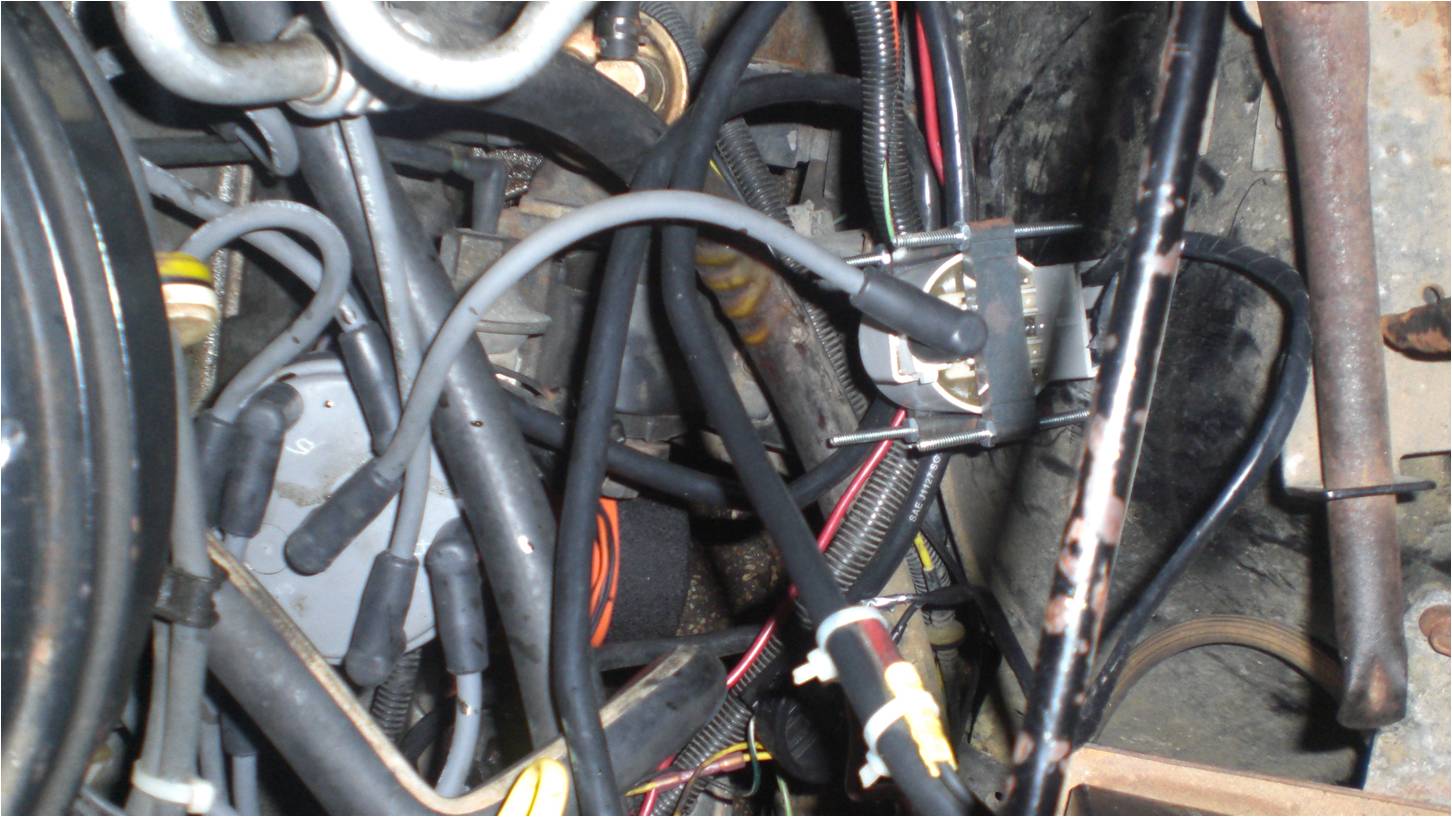

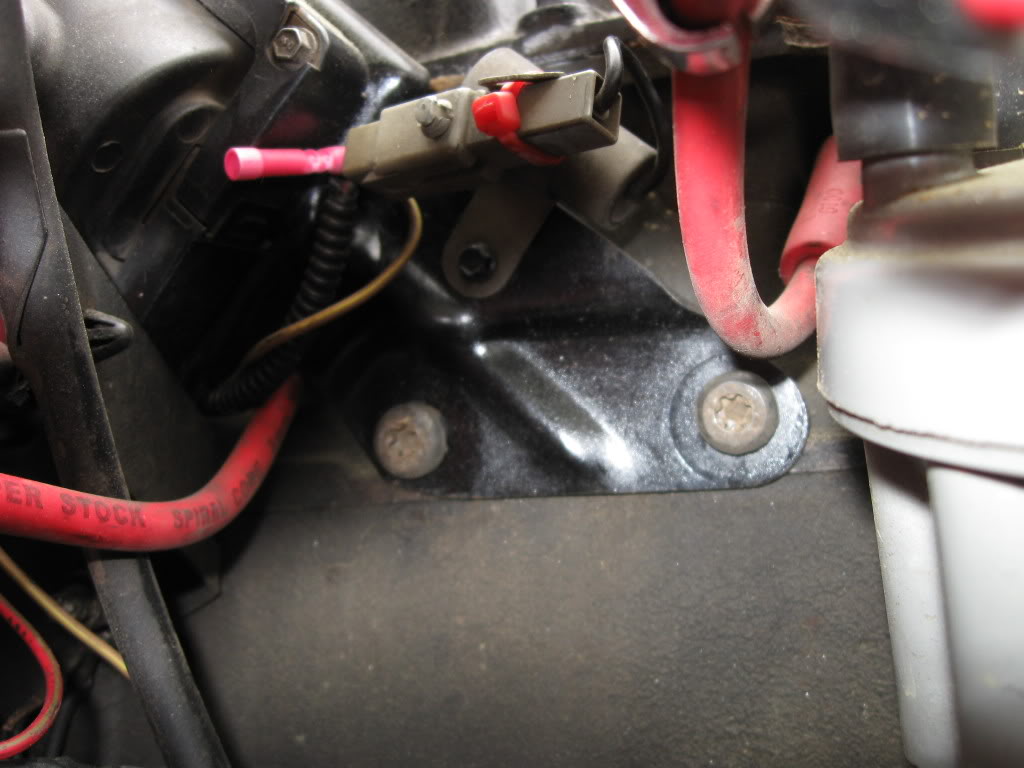

Kind of tough to see it here, but I used the escort mounting bracket. It's holes line up with the ones in the 4.2L block, just had to trim off the unwanted part of the bracket.
I think I worded this poorly...I did put an E-coil in and I'm thinking that is what's gone bad. I put the old coil back in, for trouble shooting purposes, just to see if the engine would at least turn over for me...but it didn't. Another part of my concern was if that, as a troubleshooting procedure, was a valid thing to do since the 45 gaps were still in the plugs. Here's a pic of my E92 I bolted to the passenger side of the engine bay.

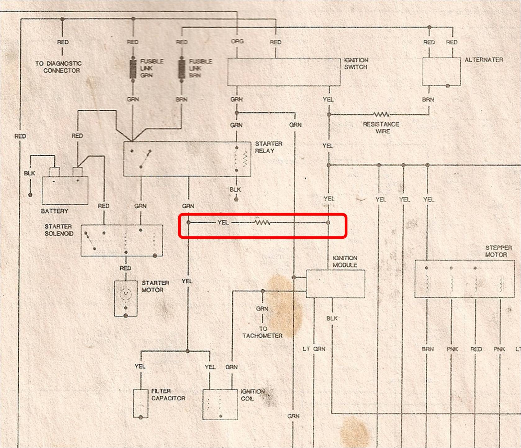

There are 3 wires from the Ignition module to the distributor, are all 3 properly hooked up to their respective terminals?..There are also 3 wires going to the Ignition module; White(Starter solenoid),Dark green (Coil), Red with a tracer(Coil and ignition switch).Somewhere between the ignition module to the ignition switch on this red with a tracer, is a resistor wire. Check it for continuity. Most of the time, after upgrading the coil, this resistor wire will burn and or break internally.
Okay, is this the wire you're talking about?
Holy crap, that looks exactly like what I did to bolt that coil on.

Mikey, I just did the continuity test on the resistor wire we've been talking about and my multimeter beeped at me, it's still intact. Anyother problems you can think of.
