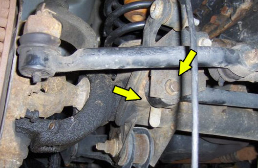

Here's a great test. Have someone start the Jeep and man the helm. OK, someone you trust to keep it out of gear and their foot firmly on the brake :)
Now, you go lay down in front of the Jeep. Focus on the bolt that goes through the bushing where the track bar mounts in the bracket there on the passenger side.
Now have your driver rock the wheel back and forth. Not a lot, just like:
2 - 10 - 2 - 10 - 2 - 10
As you watch that bolt, does it move at all? Does the front of it stay in place, but the back moves? Does the bushing give noticeably before "catching" and then shifting the Jeep?
If any of that is happening, then the BACK side of the bolt hole is likely no longer circular or the bushing is just plain worn out. This happens often on TJs and XJs. Tragic flaw. Once that happens, the trackbar no longer has a good stiff mount and even that little amount of give is enough to translate upstream and cause death wobble.
Good luck!

Thanks i will try that i have a friend that told me to rotate my tires too and he told me that i will prob need a new track bar so i guess i will have to try that thanks alot man thats some good info
