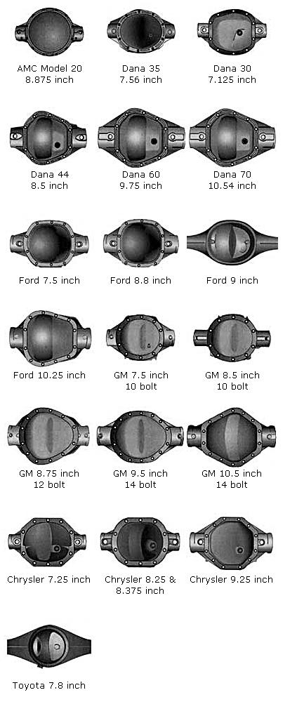

seems like a visual inspection of the diff cover may let you know. im not positive on that though.
try this

Wagoneer has either a D44 or AMC20HD rear axle. The D44 is more octogon shaped and the AMC20HD is big and round like a basketball. Front axle is a d44.
You don't find the D60 rear until you get into the 3/4T J-trucks like the J2000 and J20, or larger.
Thanks for the chart. I looked at the bolt pattern before posting this, but they both have the same pattern. The 60 is obviously much bigger/beefier.
Thank you Bounty Hunter.
Edit- Mine has the D44 in front and rear. Thanks again.
