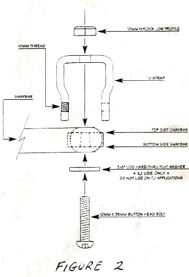

This may be a silly question but this is how my JKS worked. the U bracket went on top of the Sway bar and the bolt went through the Swaybar Eyelet fisrt then up through the U-Bracket. This puts the pressure on the Bracket and not the bolt. Maybe THAT is why it is so High.
Like So
Seams like all that pressure on that one little bolt would be pretty dangerous.
I do see what you mean, but the problem was the bolt was a skinny bolt, and I would have had to either drill the bracket and get a bigger bolt, or use a spacer or something to keep the bolt from wiggling around in the larger swaybar holes.

As you can see from My pic and LGR's pic, our brackets would not allow for them to be mounted on top of the bar, 'cause then there would not be enough room to mount the disconnect. I dunno, maybe there would be.
I'll mess with it tomorrow. I'll probably do like Bounty said and drill the bracket and get a larger bolt. They disco's are lenght adjustable, so I'll still be able to use them after they've been cut.

Well, if you notice in the JKS Pic they have an Extra Washer for the XJ application. So, just get your JKS's and be done with it :-D

Drilled out the bracket, got thicker bolts, and now they are as they should be. Good thing they are adjustable 'cause they would have been too short after cutting them!
