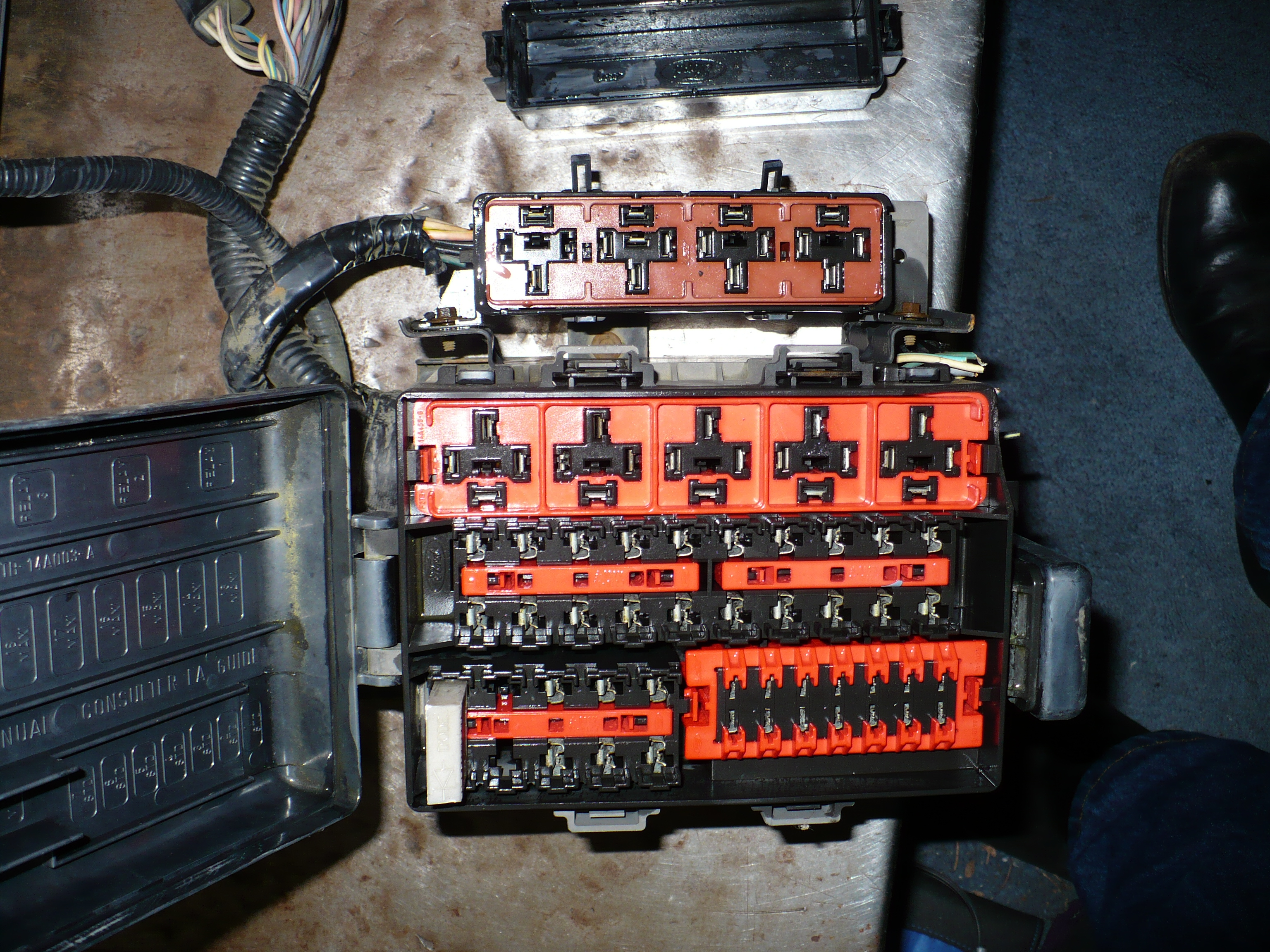

What do you plan to run off of the aux fuse box?
I would not "jump it" from the current fuse block. Consider runing new wires from the battery including a main fuse in-line. Not sure why you would need a rely prior to a new fuse block unless the new block where only powering circuits that required a "key on" circuit? I that case, yes you would need a main relay or independent relays for each device.
It's not as hard as you think......... You'll still run the new wires from the battery as described, you'll just be adding a mini relay to the postive line. The coil to the relay (A and B) can be enregized by any circuit works during the "key on" position. If you only need a "key on" and not a "acc. on" fuse block, you could use the igintion wire. Regardless, you have several options as the control wire for the new relay.....ie: feed wires to wipers, radio etc.
