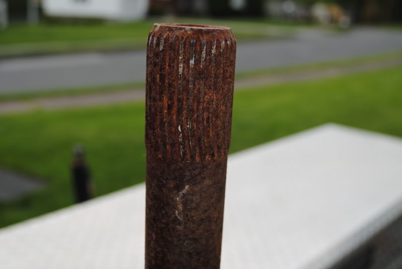

SO I finally found a way to make D35 shafts useful.
First off, there was someone here who argued with me saying all D35's are C-clip axles.. these shafts are my old trail spares from my lincoln locked D35. all 87-89 D35's were marginally stronger non-C-clip axles. you can clearly see the rotated splines, these were beat on pretty well, these have been sitting in the back of my garage for atleast 8 years. (when the D35 came out of the jeep)

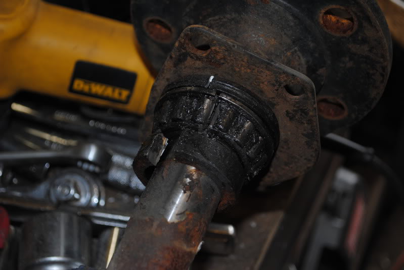

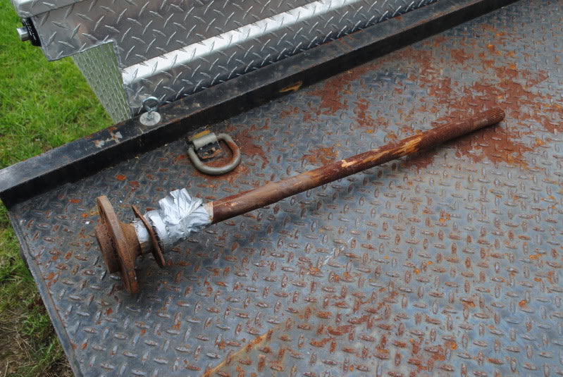

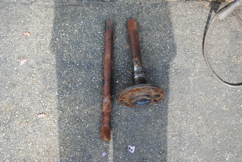

Again these were non-c-clip shafts, the bearings, and retainers needed to come off, cut off wheel was way quicker than using a press when you don't care about putting a curf in the shaft body.
Then a little cut here, little snip there

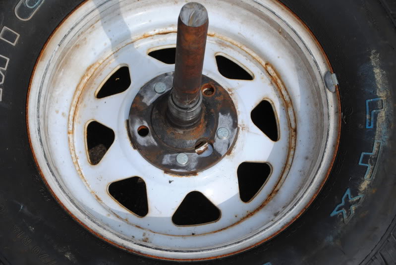

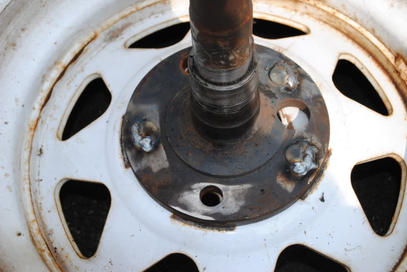

I then went to the parts store, I got some wheel studs and lug nuts that matched the ones on my trailer (they were a little smaller than the stock D35 ones, but I just welded the back of the studs in place.)

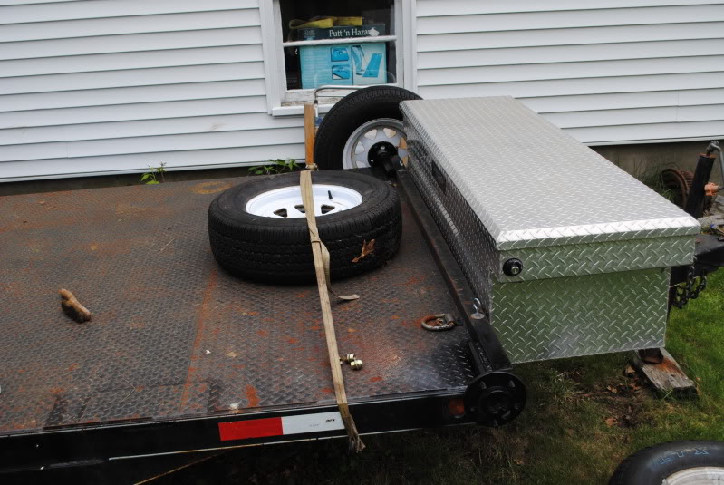

Then I simply put them on the trailer and welded them up, little paint and mounted a couple spare tires. I still have one more spare tire to mount some where, for now it is just strapped to the front of the trailer. ever since I blew two tire on my trailer in one day, I can't carry enough spares. Also, don't bother to point out that my spares are not "trailer" tires, I know. When I bought the trailer, one of my arguements to the seller that brought the price down was that none of the tires were "trailer" tires, but I replaced them all with "trailer" tires shortly after taking possession, hense why I have so many spares.
SO I finially found a use for D35 axle shafts, hope they don't snap
