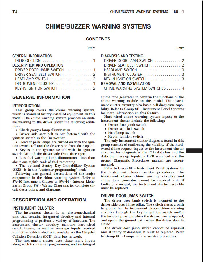

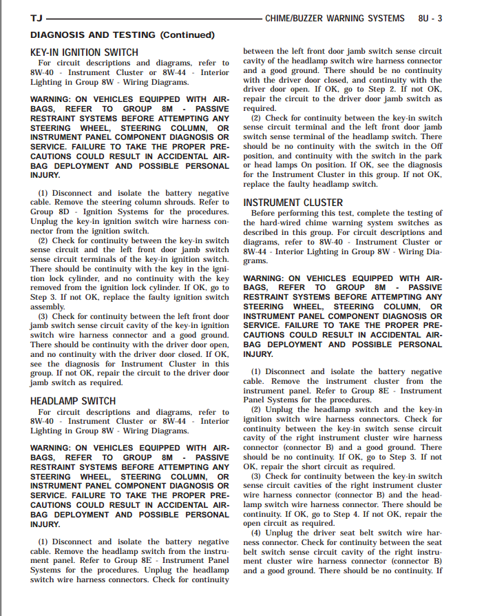

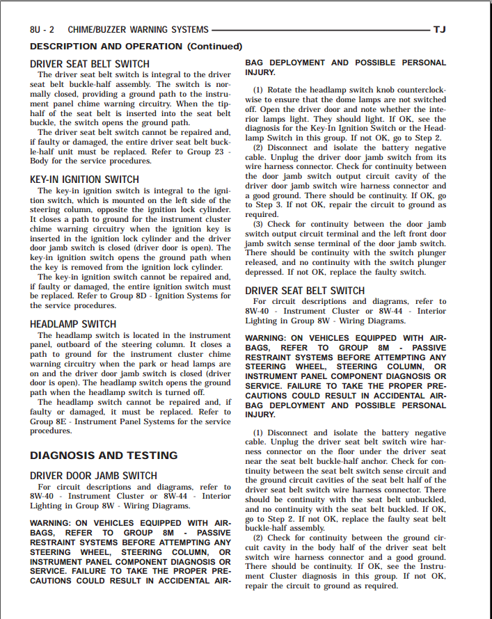

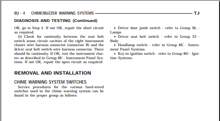

I know this isn't the wiring diagram, but it may help.
