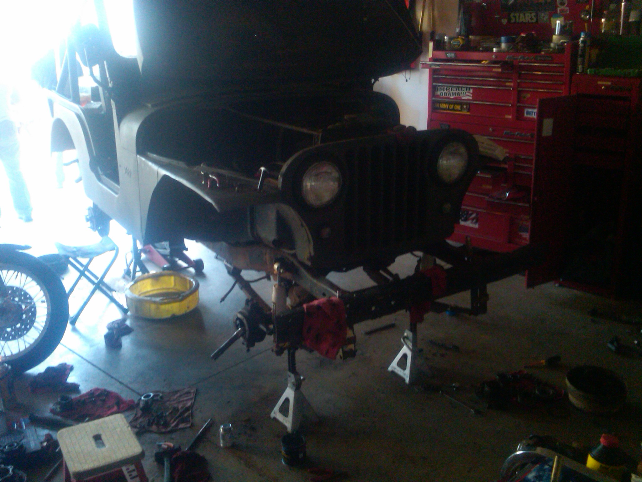

I have the 4 cylinder F 134 engine with the 3 speed transmission. I am not sure what the transfer case nomenclature is but it has two sticks. The left stick has an in and out position. The right stick has 4H, N and 4L positions. I only took one picture so far but as you can see I have removed the brakes. After this picture was taken I gutted the front axle and differential for a good cleaning. I found out it has the Dana 27 up front and Dana 44 in the back. The previous owner seems to of had taken multiple parts from different jeeps and made one. The windshield is a later model with the wiper motor on the bottom. It has a "Willys" stamped tailgate. The body has a data plate on the drivers side firewall that is clearly not original It says manufactured by AM General Corp and lists a 11 digit serial number that has been semi scratched out. The grill, body and windshield are all different colors under the spray paint OD green. I am hoping to find out what year the engine is based off the serial number. It is probably the oldest and only original part on the jeep. Thanks guys! More pics to come as the project progresses.

Sounds like the t-90 3speed and the d18 transfer case .... Based on your pic I'm not sure how original the body is .. But in gonna guess it's late 50's early 60's I have the same engine transmission and tranfercase. But with a Dana 25 up front an a 44 in the rear
