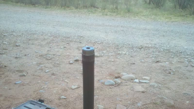

Here is a picture of the shaft, only engages like half an inch of the splines the marks farther down the splines are from the stock limited slip diff I had a year prior that engages like and inch and a half of splines.

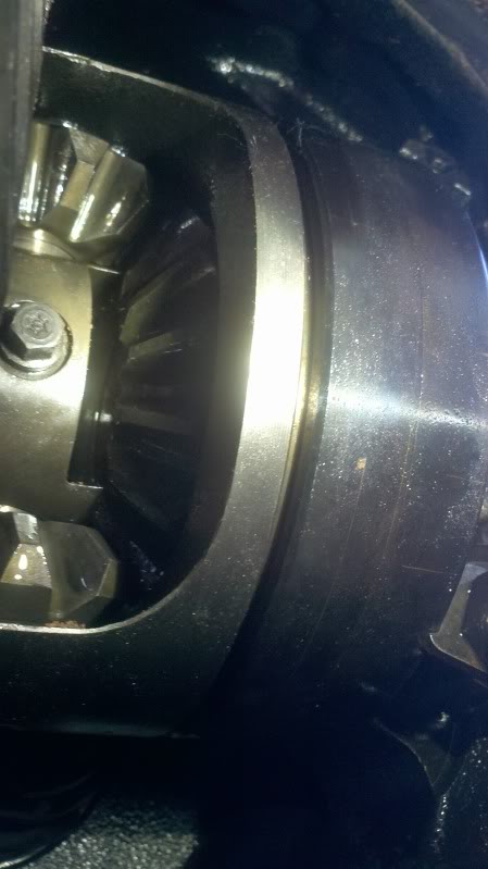

This pictures shows that the axle fully inserted it engages all the splines it can, the shaft is not too short. this is the locker disengaged but engaged does not change the spline engagement.
