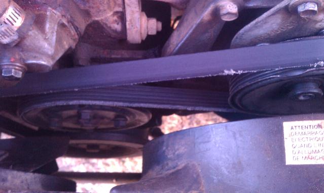

Ok so u have a 4.0 i6 and recently my serpentine belt got messed up somehow so I replaced it and now it makes a weird rattling noise. It sounds like some small aluminum tubing being rolled together. I have chased it to this pulley that feels loose but I'm not sure what pulley it is or how to tighten it up.. Thanx for the help. Oh it's the one in the middle of the engine

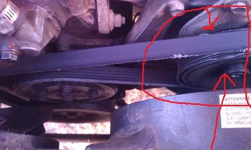

Ok first off this pulley needs to be replaced its bent both on outside and on inside see arrows
also notice the fraying on the serpentine belt that should be replaced also
as for loosening or tightening the belt there is an adjuster behind the power steering pump
Ok.. Thanx guys... Thats what I was doing when I took the pic.. I just didn't know what that pulley is... I like the red arrows
