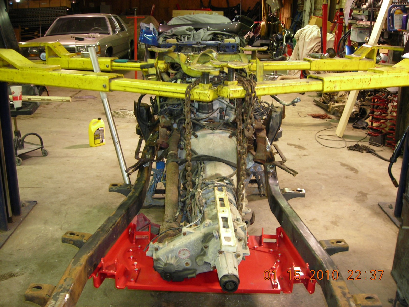

the first pic shows where on the frame the engine mounts were welded to.

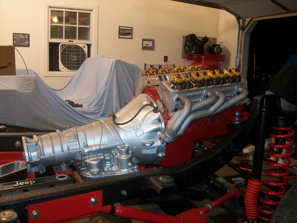

second pic shows how long the whole assembly was during mock up

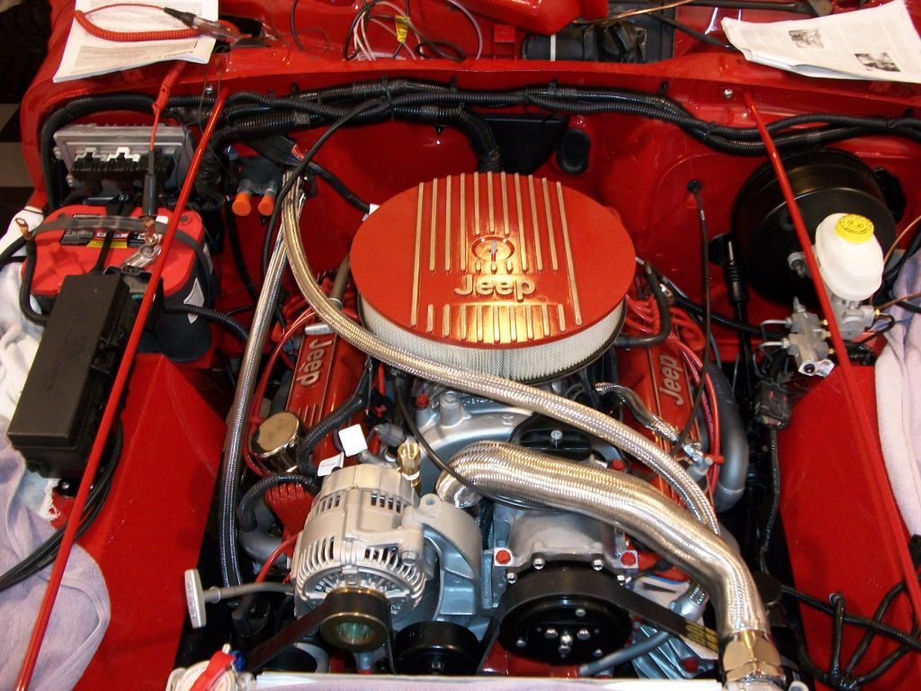

last pic shows how it looks in the engine bay....
