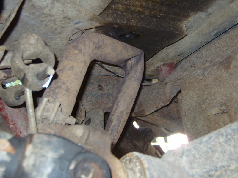

Here is what my down pipe looked like after a trail ride couple weeks ago. The S bends turned into Z bends, which is why my jeep would not stay running.

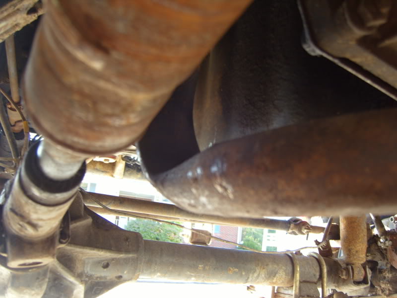

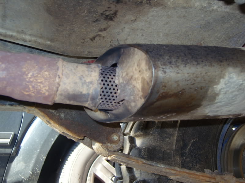

As you can see, I didn't have time or desire to fix it properly for a fall comp event (which was the following weekend) so I just drilled a bunch of 5/16 holes just after the manfold flange, had that real nice big block sound :

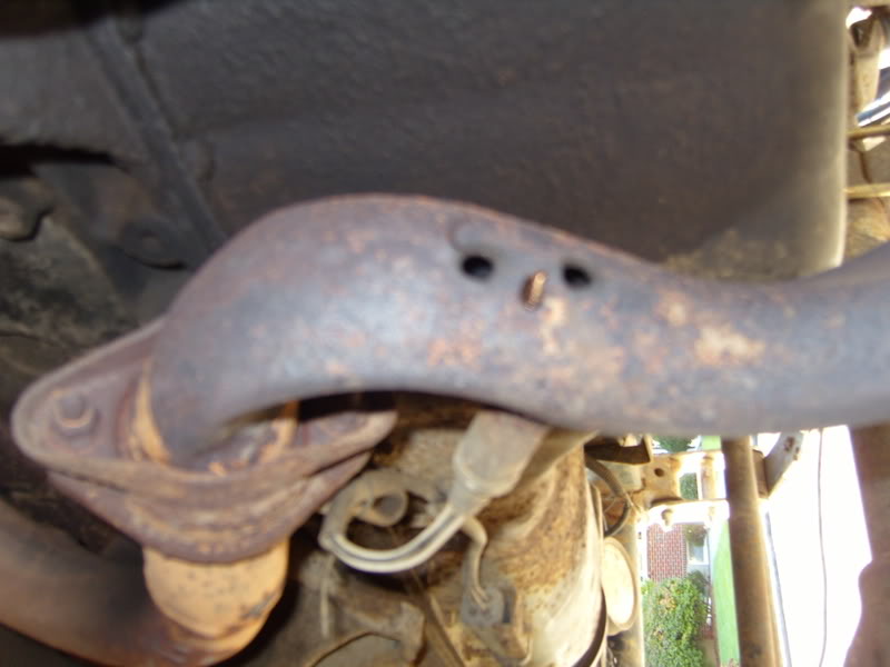

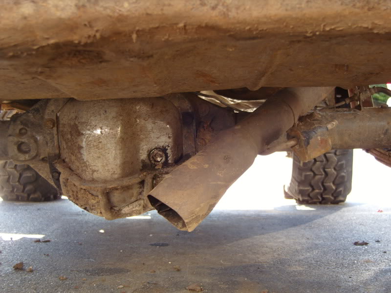

and here is what I did to it at the fall comp
