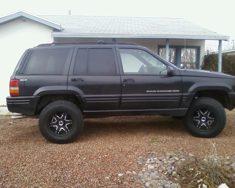

Hi all, I am going to lift my jeep from 3" to 4" and I am wandering if I use a yoke from a front axle to extend the rear so I can move the rear axle more center??
The pics should show what I mean.

When the jeep was lifted 3" the axle move forward which the wheel moved closer to the fender well, so once I lift it another 1" it will move closer, so I will need a longer driveshaft to move the axle back which I'll be using adjustable control arms too.
You can get fixed lower control arms for a 4" lift that will return your wheelbase to where it's supposed to be. Have you looked at the slipyoke at the back of the transfer case to see how much lengthening you will need in the driveshaft?

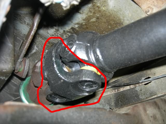

On the transfer case I don't have a slipyoke I don't even have a slipyoke on the front ether, the 5.9 came with full CV's, my t-case is a NV249, or was it a NP any way. The yoke for the front, which is circled in red in the pic, it's by the t-case will it work on the rear to lengthen it? Did the question sound bedder? I was never good at trying to explain something. :redface:

Your front driveshaft uses a double-cardan joint at the transfer case, commonly (and improperly) known as a CV joint.
The CV joint is not interchangeable with the slipyoke on the rear output. Your best bet is to have the stock rear shaft professionally lengthened at a driveshaft shop.
Ok it is a slipyoke and it is stock. A double-cardan that's what's it called ok.
