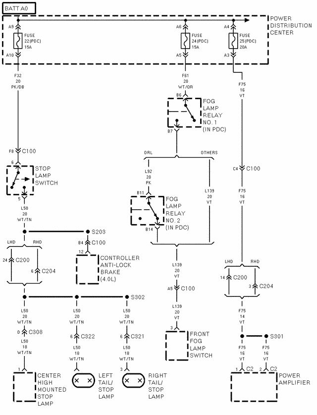

LauraBoston New member Feb 27, 2008 #3 i don't know what sales code you have, but they change depending when your vehicle was built...i found one for fues 24 as well, in the PDC a 15A fuse also got 2 relays...both in PDC.
LauraBoston New member Feb 27, 2008 #4 here's one of the diagrams. Attachments xj807114.gif 24.1 KB · Views: 138
