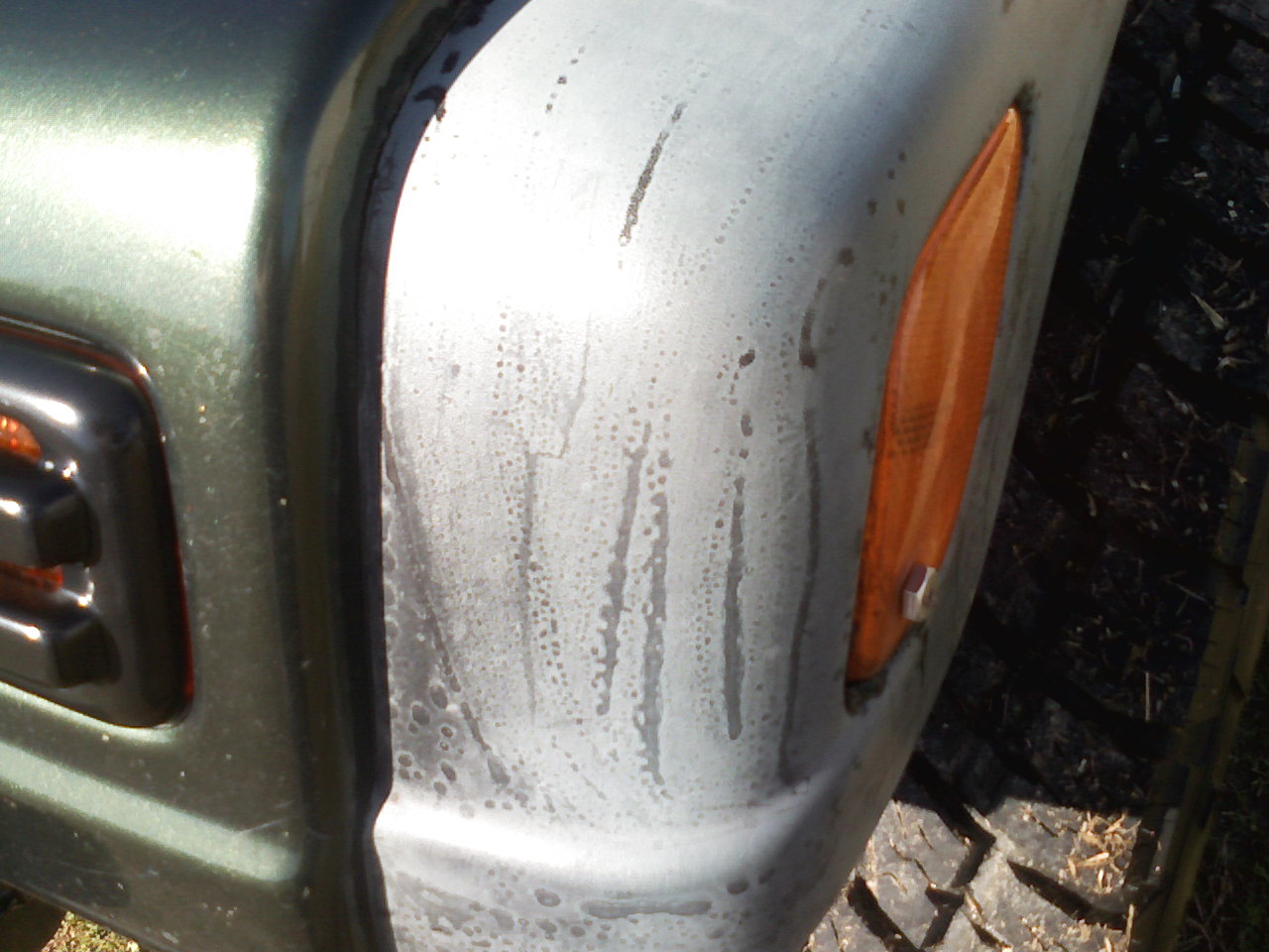

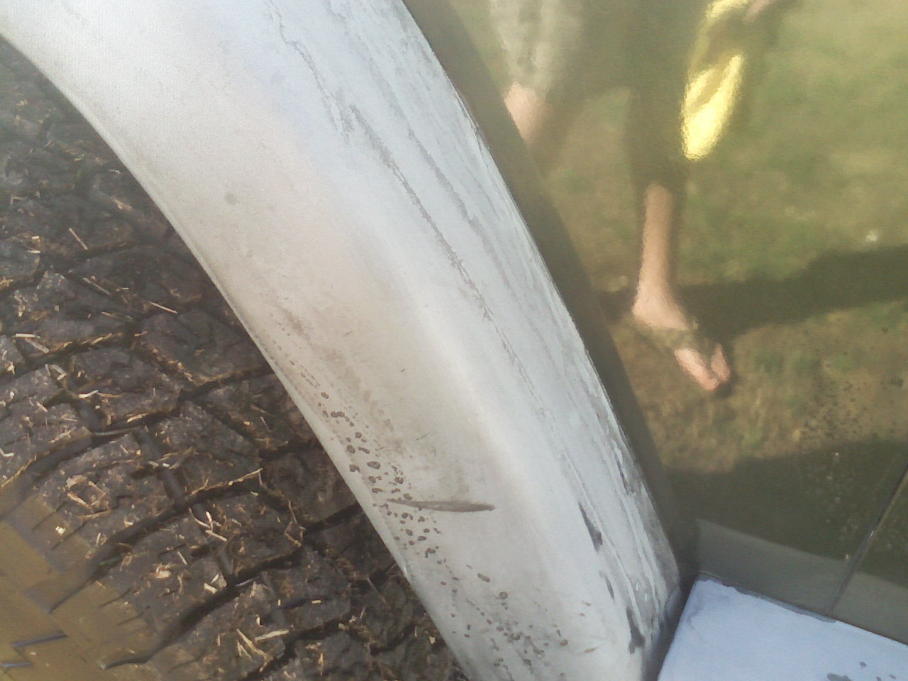

Have you ever seen anything like this, and it will change if water hits it.

They look like most faded flares, don't know why water affects it.
A heat gun works very well to bring back the black. Start far away and slowly get closer, moving back and forth like a spray can. The black will come back to the surface.

Ok i'll try the heat gun, but whatever is on there it can be scrubbed off but it takes some elbow grease.
If you want a different look you could also scuff them and apply some herculiner are comparable coating.
Hit them with a pressure washer before you do anything permanent.
My flares seem to build up a white skin or film of some sort that looks like what you have. I hit them with the pressure washer and it comes off, then I use "back to black" to shine them back up.
I tried the pressure washer it didn't help, it looks like someone tried to wax it and it dried on there and caked up. Its been on there ever since i got it. If water runs down it, it will hold the shape of the water
Try cleaning with simple green or a solvent of some sort, sounds like a previous owner used something on it to try to get them black again.
