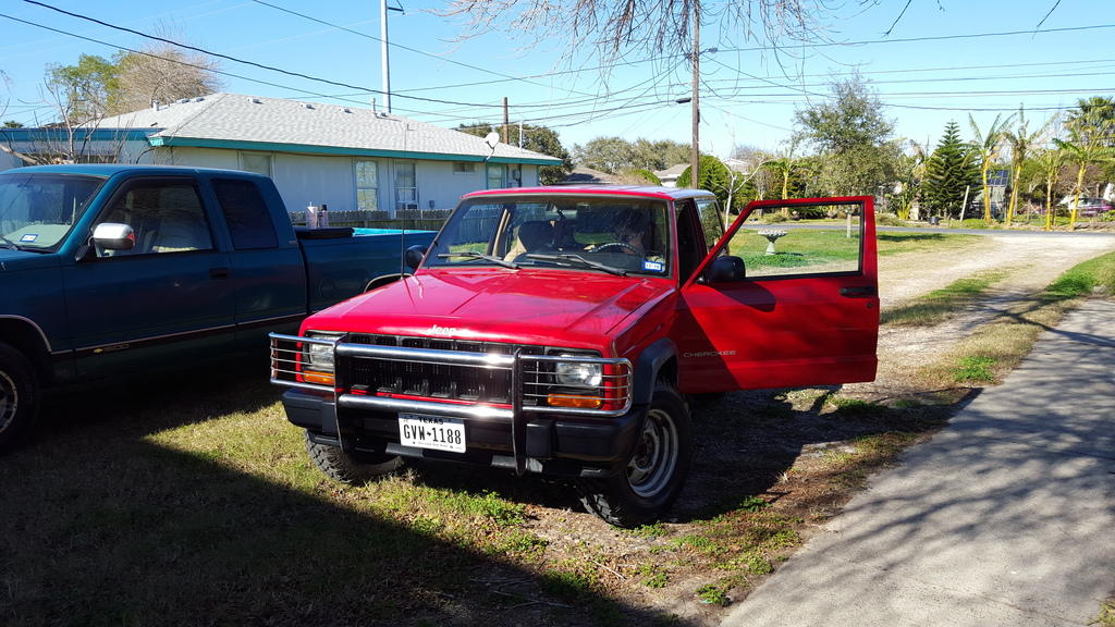

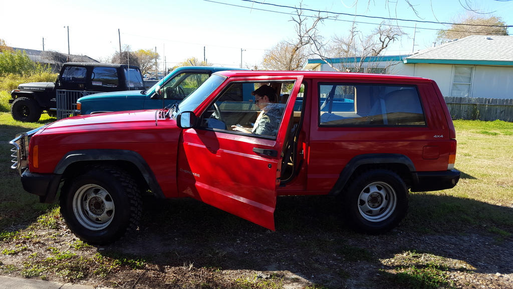

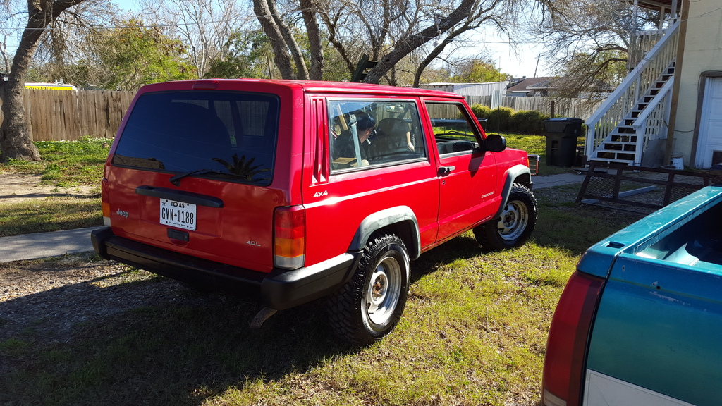

Finally, pics of the cherokee ready for daily driving.

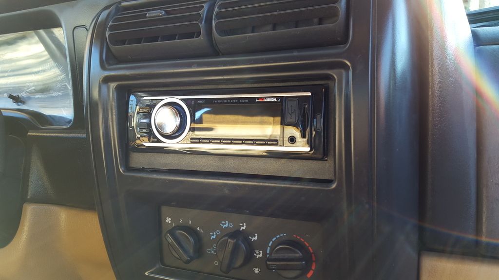

We have to figure out why the radio adapter kit leaves a gap underneath. That is the proper one for that year cherokee but it came out with a large gap.
That radio is so cool too. It was 20 bucks and Bluetooth to the phone, has a memory card slot, auxiliary in port, usb, and has normal am/fm. No more stupid cd slot, either. And the craziest thing is its half the depth of a normal single or double din radio so the wiring harness isn't all jammed and squished behind it. I am going to put one in the old wrangler once I get the wrangler fixed up completely. I only use the "radio" part of a car stereo anyways so it's perfect. And the Bluetooth so you can use the speakers to hear the conversation on the phone helps alot. That radio is at walmart, if anyone wants to check them out
