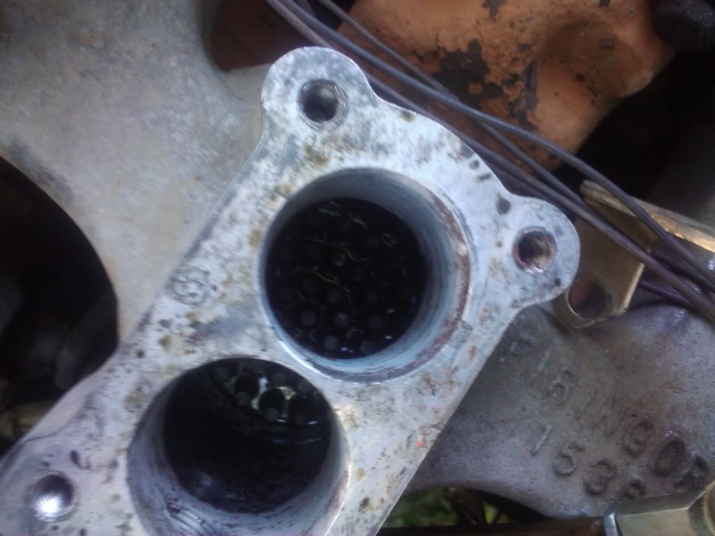

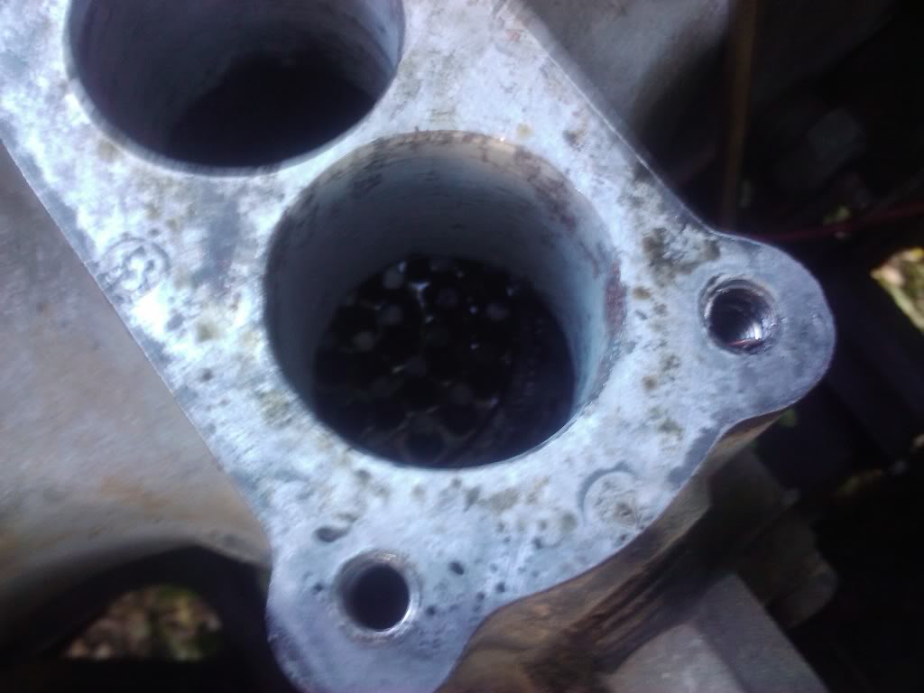

while i had it off, i looked in the bottom of the intake and its got some weird shizznit down in there. check it out
now, i can think of two reason for those being there, they are both probably wrong but i'll tell ya'll anyway.
1) they are there to cause some strange turbulence to mix fuel in some odd situation that i have never come across in any other vehicle.
2) they are there to catch crap i drop in the intake so it doesn't roll down the intake runner.
i have no idea why but i am going with option two because i am a huge fan of dropping crap in the carb while screwing around just to make my day less fun. :x i do it fairly regulalry so i can improve my engine disassembly times.

What you see at the bottom of the intake manifold are the pins for the manifold heater to preheat the fuel. You should see a red wire going from it to the manifold heater relay, it is also connected to the choke heater from that relay for use at engine startup.
hmm, was wondering also if it was that but that was lower down my list of things it would be since mine is not plugged in
