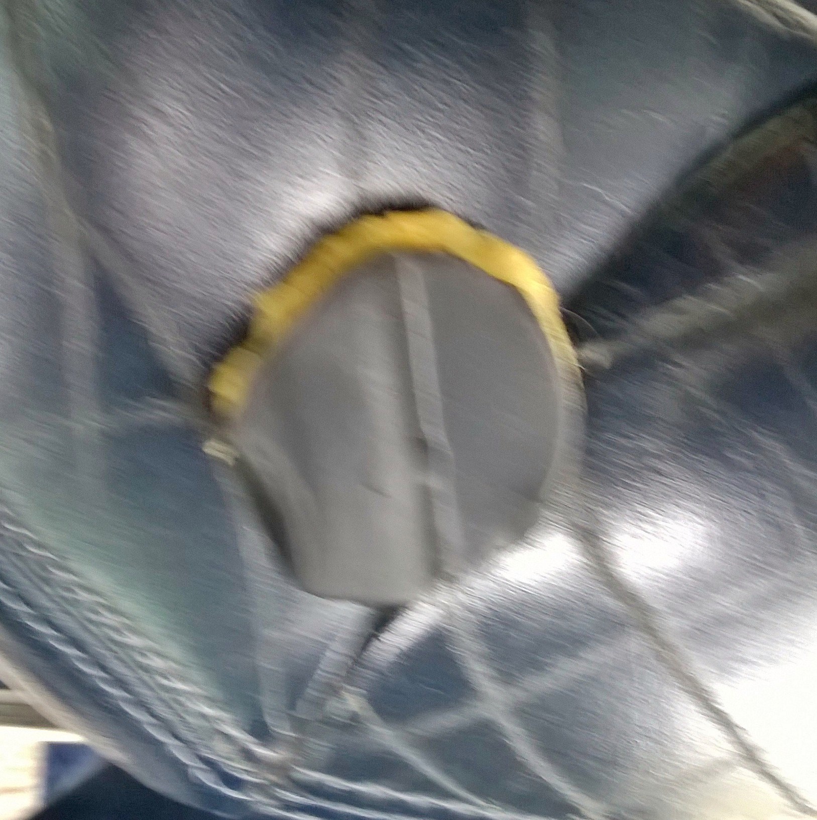

You will need to find a rubber grommet to punch a hole through or if its an automatic, there should be a plastic body plug where the clutch should be if it was built with a manual trans..

There may be wires already run. There was on my '05 all I had to do was replace the turn signal/light switch & add a fuse (& fog lights of course)

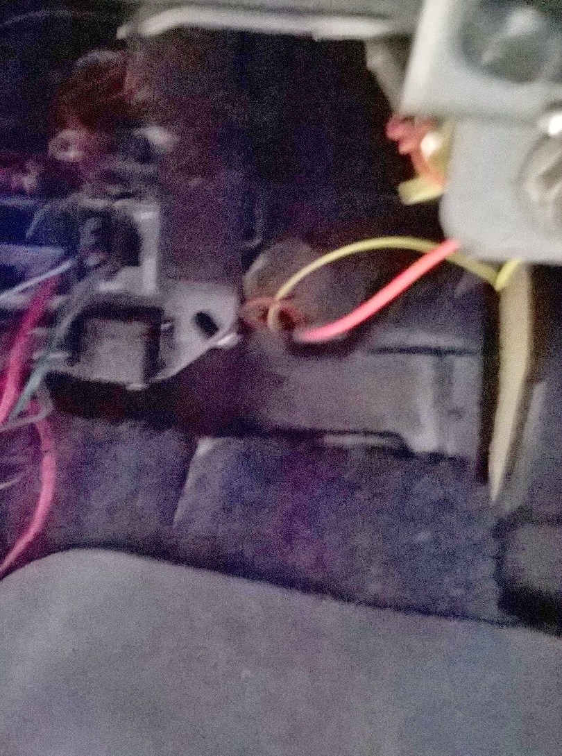

Most jeeps have wires running through the firewall into the column or other area. Just trace those wires and zip ties will be your friend. My TJ looks like a gaming computer on the inside with all the lighting and things that have been ran.
