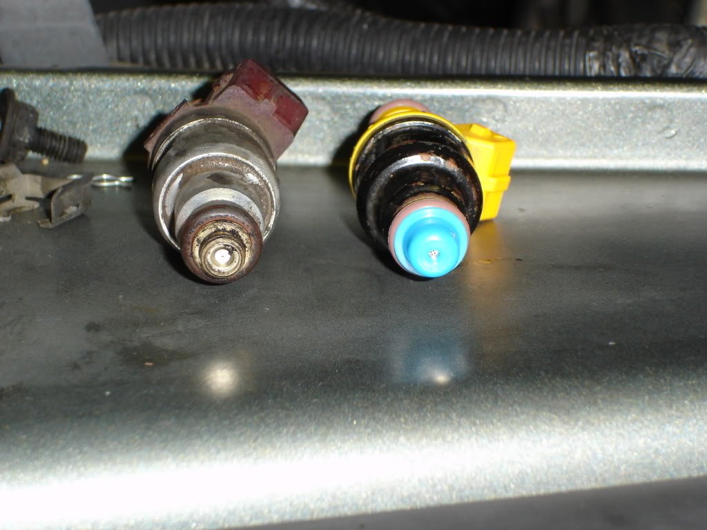

I used injectors from a mid '90s Ford Crown Vic v8 in my '95 YJ, ran a lot smoother. Went from a single nozzle to 4 nozzles per injector.
I don't have a part number, just grabbed a bunch at the junkyard at $5 each :twisted:
Here's some good jeep injector tech: Login
Here's a good pic of the difference in nozzles, you can guess which one provides better fuel atomization.
