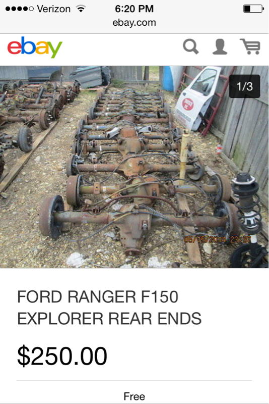

Scrap the d35. You can by a ford 8,8 online for $375 comes with new disk brake rotors and pads. New brackets are around $200 and and gears are under $300 for it and it will
Be bulletproof. That's my next mod , I'm running on borrowed time with my d35 and 35" tires, worst axle ever. I've seen way to many break, and it will break anywhere, the housing, carrier, axle shaft, or ring gear. Junk
Look on eBay, there's an online store that has lots of them. Gears are a bit tricky to put in but everyone knows someone that can help, do a favor for them
