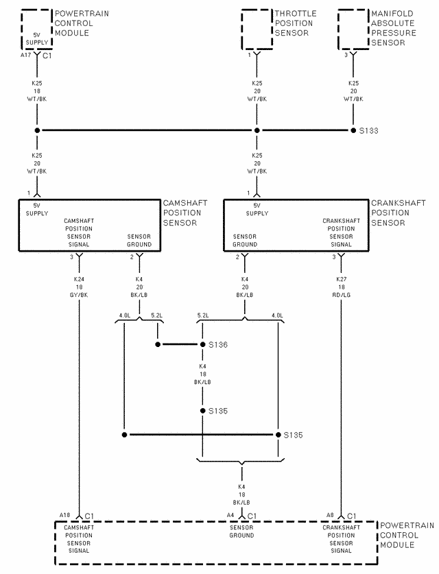

  4. If voltage is still not present, check for voltage at the supply wire. For wire identification, Refer to Wiring Diagrams.
  5. If 5 volts is not present at supply wire, check for voltage at PCM 32-way connector (cavity A-17) Refer to Wiring for location of connector/terminal. Leave the PCM connector connected for this test.
  6. If voltage is still not present, perform vehicle test using the DRB scan tool.
  7. If voltage is present at cavity A-17, but not at the supply wire:
  8. Check continuity between the supply wire. This is checked between the distributor connector and cavity A-17 at the PCM. If continuity is not present, repair the harness as necessary.
  9. Check for continuity between the camshaft position sensor output wire and cavity A-18 at the PCM. If continuity is not present, repair the harness as necessary.
  10. Check for continuity between the ground circuit wire at the distributor connector and ground. If continuity is not present, repair the harness as necessary.
