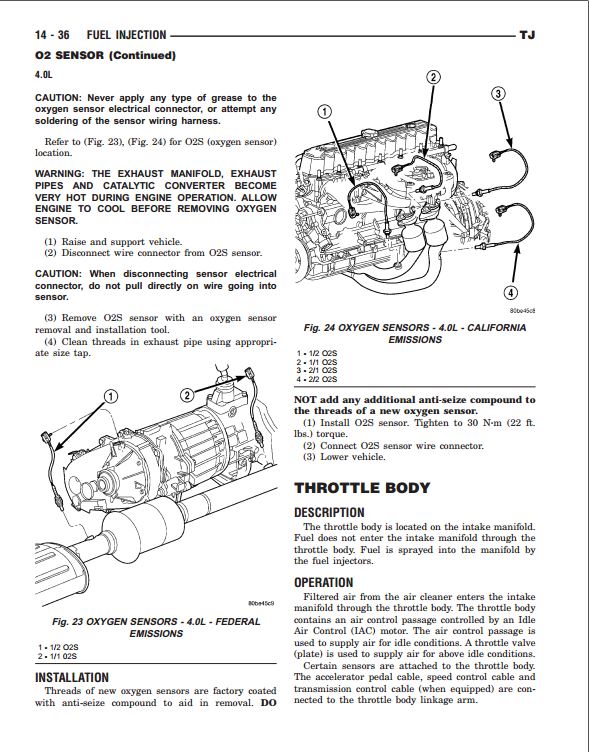

are you talking about fig 23? i thought yours was a 2.5? those pics are for a 4.0
I've got a weird Jeep. It's a 2005 Wrangler SE with an automatic. Jeep learned that the auto transmission doesn't go well with the 4 banger, so if you ordered a later TJ with an auto it automatically bumped you up to the 6. When I go to the parts store I normally just tell them I have a Wrangler Sport.
the short of it is that I've got the 4.0L
