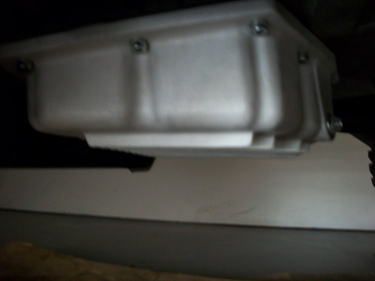

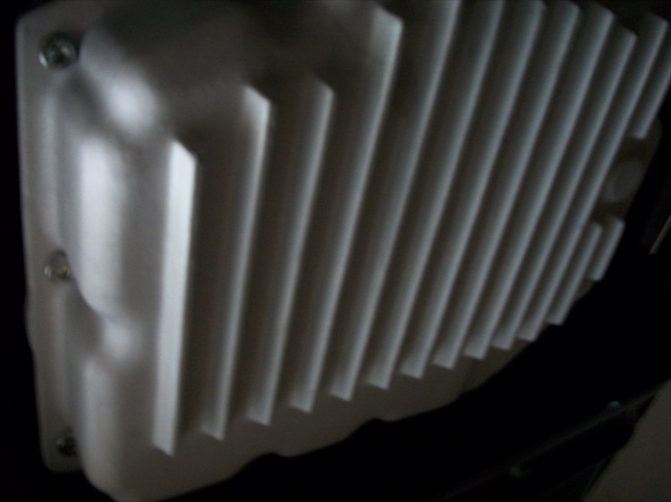

Well the pan is aluminum which I love vs the stamp steel stock one that holds a little more heat. I'm not sure how much more it will help but, I'm thinking with almost two quarts more capacity along with fins on the bottom of the pan should help get alot of heat out especially since I took my transmission cover off and there's more fluid to absorb heat along with my 4.56 gears that keep the transmission from shifting all the time. I will report back with the different temps. So far I run 195 to 200F in the hot afternoons and 175 to 180 in the mornings. I know sitting in traffic or going up and down hills I easily hit 210 to 215. If it doesn't run any cooler I will def look at a cooler. I have been eyeing the Derale one but, might have to wait on that have a little kid on the way.
Transmission runs about 15 degrees cooler with 100 degree temps. I also have noticed that the pan stays pretty warm for a good few hours vs the stock one that only stayed real warm for about 20 minutes. My before temp was 195 to 200 and I now run 175 to 180. In the mornings when I was about 175 with the stock I hang about 160 to 165. holds about a quart and a half more. Plus has a drain plug which is awesome. The transmission should last a lot longer.

Yes but, to drain the pan by using the drain bolt you will have to remove the cross plate. I don't run mine anymore only because I don't offroad plus it allows more air to pass over it with the cross plate not being there.
