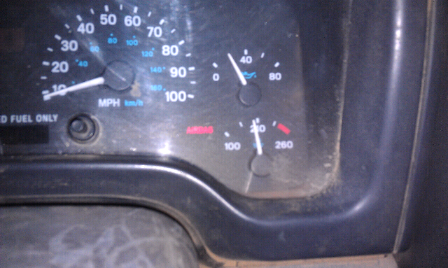

This is what the temp reads after awhile. It doesn't go higher or lower than that which leads me to believe that its running temp. Does that look normal?
No that is not at temp. You should be at 210* when at temp. Perhaps your thermostat failed open or the wrong temp thermo is in there. You should have a 195* thermo installed.

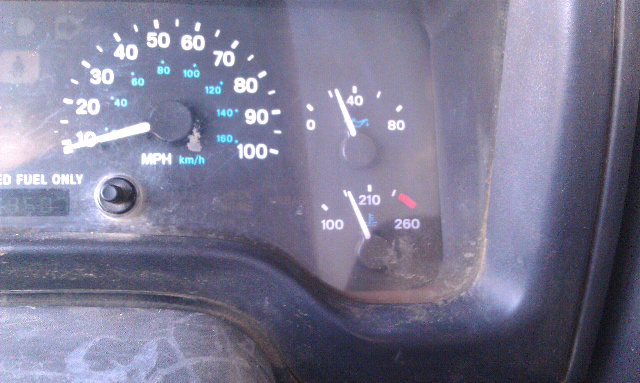

The old thermostat was rated at 195. But would imagine it was worn out and open to early. The new one I installed was also rated at 195 and this is were it currently rest. Also cleaned out the coolant sensor
That is where you want to be. And, YES your old thermo likely failed open.
