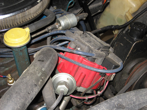

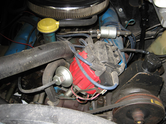

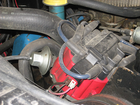

I put one on my 360 and love it. I got it from Zach at Z &M in Ohio. Yes, it's tight, but it fits. Here are some pics that might help you.
the pictures you have poster have been helpful! can you post some more of how you hooked it up??
Actually it wasn't that difficult. Had my "mechanic" son help me. We took off the old dist. cap and noted how it lined up (where #1 was pointing); then we pulled the old dist., removed the bottom gear and placed it on the HEI, inserted the HEI and locked it into place, again, noting where #1 pointed. Replaced the cap on the distributor and connected the red wire to a 12V source. (the black wire goes to my tachometer). Fired up the Jeep and made minor adjustment to get a good idle. I love this thing, especially in that it cleaned up the engine compartment. Got rid of the coil, the cumbersome Ford electronic block and a resistor block. All those electronics are included in the solid state component in the cap of the HEI.
