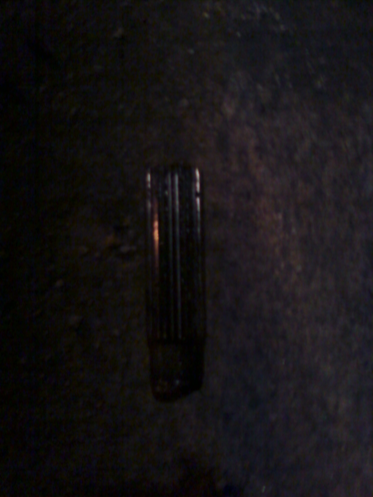

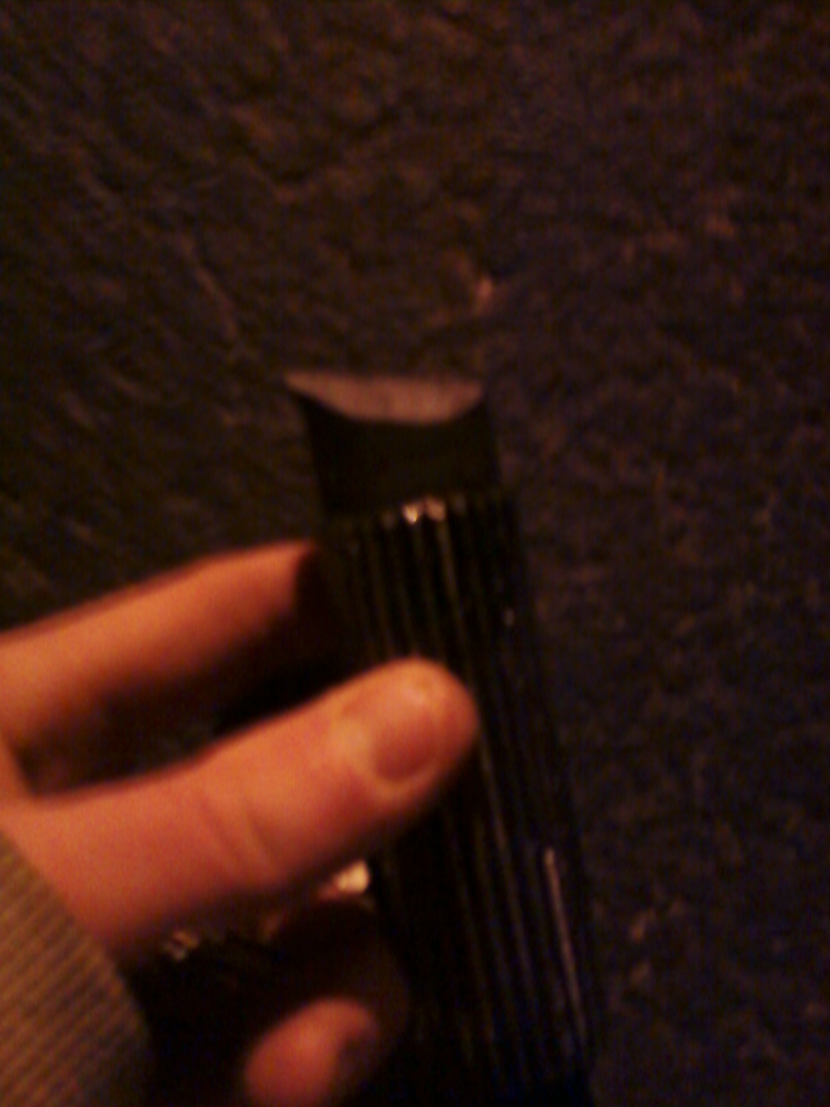

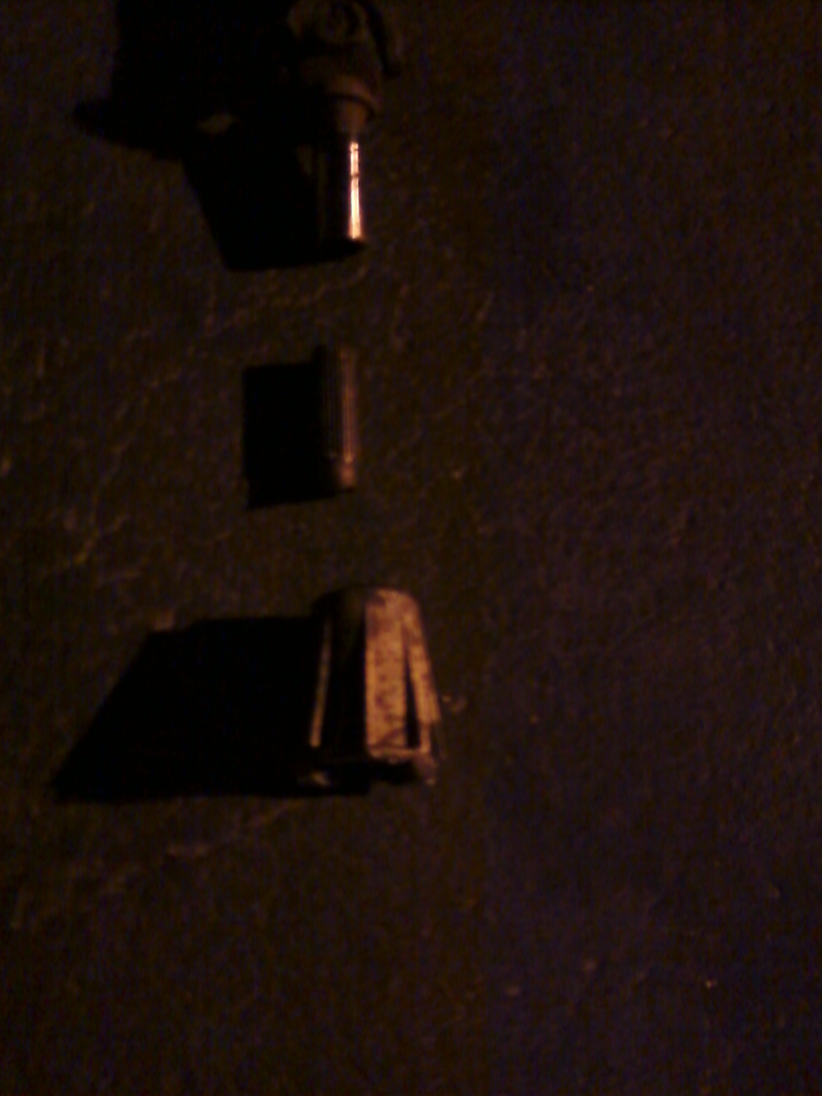

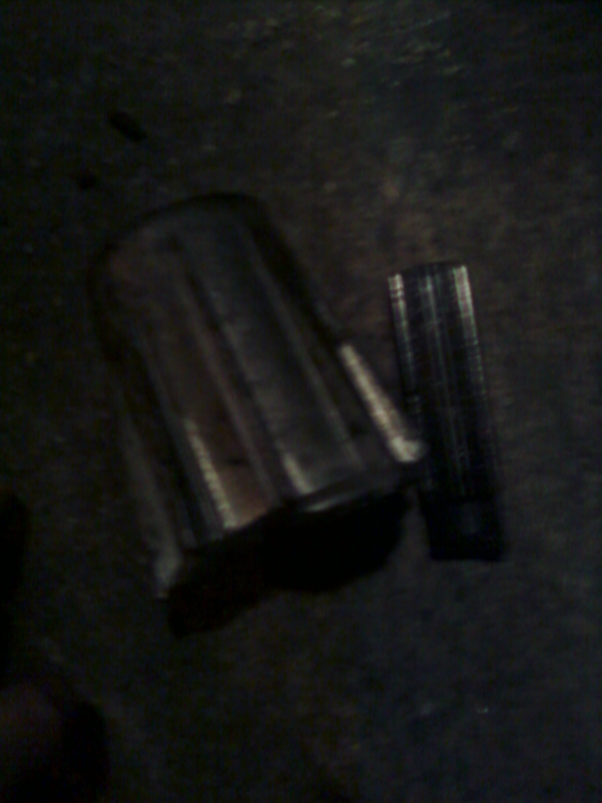

i was on my way home tonight and bam. my spline shaft on the transfer case broke of and my drive shaft droped out what can i do can i replace the spline shaft or what need help please.

You can replace the output shaft and tailshaft housing and other components that may have suffered the same faith without having to replace the whole t.case.

Your transfer case can be repaired in the jeep, but may be easier to remove it. It will need a new mainshaft, tailhousing, and tailhousing extension. I have all those parts if you're interested (if it's the 231).
If you were close to St. Louis I'd rebuild it for you, would take about an hour. Could also rebuild it if you wanted to ship it to me.
it the pics is what broke the transfer case say the ratio is 272 so is that what it is
No, higher on the tag is the model number, either 207 or 231.
It's possible there are more problems inside. No noise or abuse led up to this breakage?
no abuse led to this i think what happen was the cap on the u joint came out and then the drive shaft feel out. then the drive shaft when crazy and snapped the whole thing. i think and i will check the tag again tomorrow it too cold and dark out here sorry but i will update tomorrow around 12 thanks for your help
