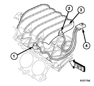

The two knock sensors (1) are bolted into the cylinder block under the intake manifold (3).
[TD="align: left"] NOTE: [/TD]
[TD="align: left"] The left sensor is identified by an identification tag (LEFT). It is also identified by a larger bolt head. The Powertrain Control Module (PCM) must have and know the correct sensor left/right positions. Do not mix the sensor locations. [/TD]
[TD="align: left"]1.[/TD]
[TD="align: left"]Disconnect knock sensor dual pigtail harness from engine wiring harness. This connection is made near rear of engine.[/TD]
[TD="align: left"]2.[/TD]
[TD="align: left"]Remove intake manifold.
[/TD]
[TD="align: left"]3.[/TD]
[TD="align: left"]Remove sensor mounting bolts (2). Note foam strip on bolt threads. This foam is used only to retain the bolts to sensors for plant assembly. It is not used as a sealant. Do not apply any adhesive, sealant or thread locking compound to these bolts.[/TD]
[TD="align: left"]4.[/TD]
[TD="align: left"]Remove sensors (1) from engine.
[/TD]
