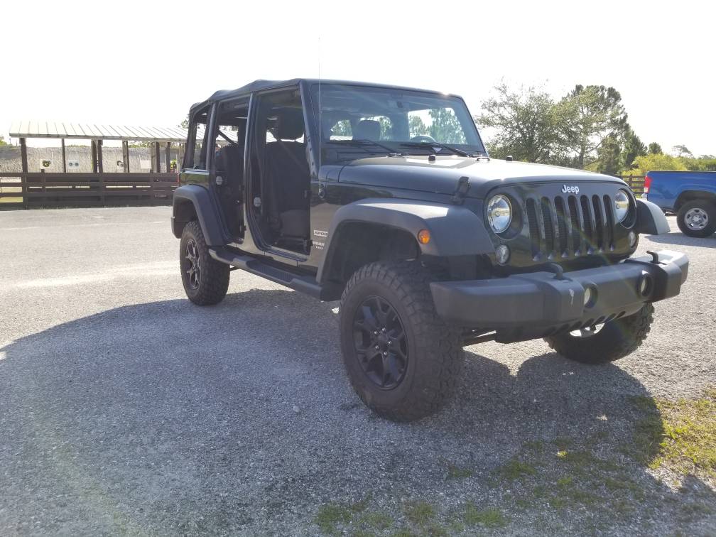

I went on a trail ride through the FL swamp yesterday and noticed a loud slow racheting sound while accelerating while 4hi and 4low were engaged, the sound went away when I went back to 2hi. I was under the jeep today and the diff levels are both where they are supposed to be and there was no obvious wear and tear or fluid spray that I could see anywhere. Im new to this so I could use some pointers to try and locate the source of the sound. 2015 jku sport with 3 inch bds lift and 32 inch tires. Any help greatly appreciated I am driving 300 miles later this week on a road trip and want to make sure nothing breaks on the way there.
